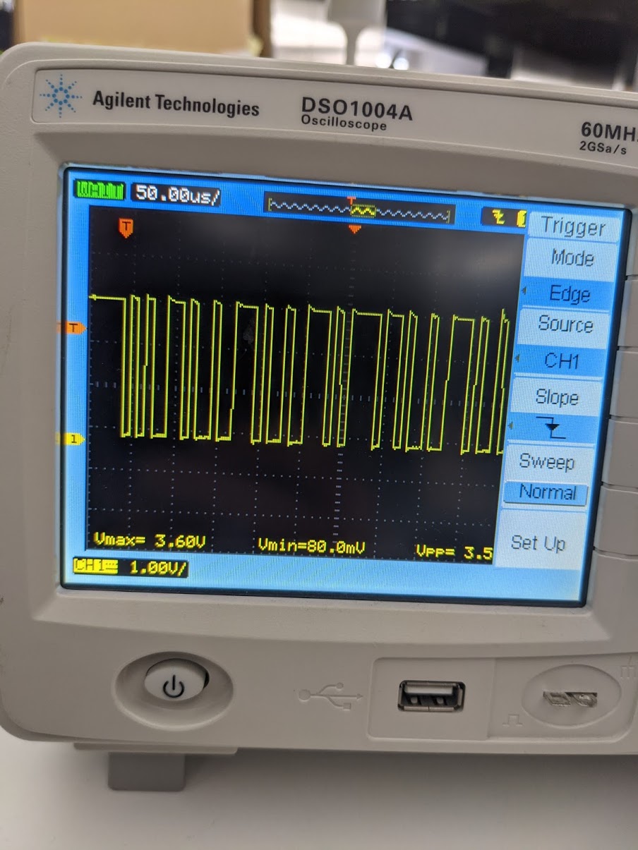

I scoped the board behavior on the Raspberry Pi, with which it works perfectly. Data goes both ways and looks good on the scope. Via minicom, I was sending a simple “$$” command which queries the GRBL firmware flashed on the board to echo back the list of all the settings.

Scoping the RX Pin on the Pi, showing incoming data from the board:
Scoping TX pin on the Pi showing outgoing data to the board:
I tried to re-create the same setup on the Jetson Nano:
The data stream in minicom is completley scrambled:
Scoiping The RX Pin of the Jetson for incoming data from the CNC board looks ok:
Scoping the TX pin of the Jetson for outgoing data from the Jetson to the CNC Board looks messy:

This helped me to get correct data. You need to connect pull down ~10 kOhm resistor from RX and TX (GPIO 8, 10 pins) to the jetson nano’s ground.
