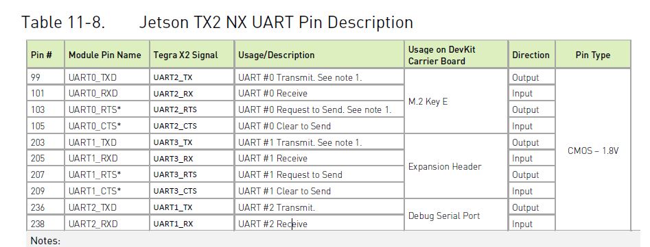

I am trying serial communication(RS232) on TX2 NX on our customized carrier board, I am using JetPack 4.5.1(L4T 32.5.1) sources to build BSP.
None of the serial ports are working for me even debug port. I have the serial ports verified on Nano/NX modules on this board.
here are my connections:
Serial 1:
PIN# | Module Pin Name
99 | UART0_TXD
101 | UART0_RXD
103 | UART0_RTS
105 | UART0_CTS
Serial 2:
203 | UART1_TXD
205 | UART1_RXD
207 | UART1_RTS
209 | UART1_CTS
Debug UART:
236 | (DEBUG) UART2_TXD
238 | (DEBUG) UART2_RXD

I thought these pins are mapped to ttyS0 serial@3100000 debug UART. What are the pins for console [ttyS0] serial@3100000 ?
please refer to Topic 153941, it shows the mappings for serial ports of ttyTHS*, and UART*
Hi I went through the post,
I see with the source/public/hardware/nvidia/soc/t18x/kernel-dts/tegra186-soc/tegra186-soc-uart.dtsi.dtsi and TX2 NX Pinmux files. Also referred product design guide. I am bit confused here.
debug serial port is serial@3100000 :ttyS0 236 UART2_TXD 238 (DEBUG),UART2_RXD (DEBUG) , is that correct? I have connected the serial to USB adaptor to these pins and it is not working for me
uarta: serial@3100000 :ttyS0 236 UART2_TXD 238 (DEBUG),UART2_RXD (DEBUG)
uartb: serial@3110000 :ttyTHS1 99 UART0_TXD 101 UART0_RXD
uartc: serial@c280000 :ttyTHS3 203 UART1_TXD 205 UART1_RXD

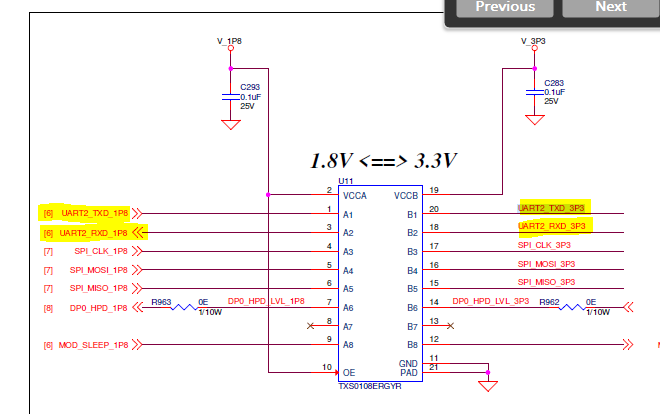

these combinations are working for me , Like if I try using minicom and connect serial cable to these pins I am able to tx/rx data.
But debug pin combination I tried to connect
to a serial to USB and used teraterm in a host machine, I get no boot console, not able to use serial console. But with same carrier board and pin config I am able to connect via serial console in Nano.
hello venkatraman.bhat,
that’s right, I’ve revise my previous comments for the UART mappings also.
could you please check Jetson TX2 NX Product Design Guide for the [Debug UART Connections].
please check the footnote, please check whether you had level shifter implemented.
thanks
I have checked, we have a level shifter
I see some junk characters on the console for all the Baud rates (I know Console Baud should be 115200, just checked with other BRs). My connections are correct as same Debug port works for Nano and NX modules on the same carrier Board.
Are some characters correct at any given baud rate on the console? If so, then I would suspect noise. How long are your RX/TX cables? Are they shielded? You might try two things:
  • Loopback, where the cable is the full length sitting as close as possible to the route it would take, but RX and TX shorted. See if echo of content has partial correct versus partial corrupt content.
