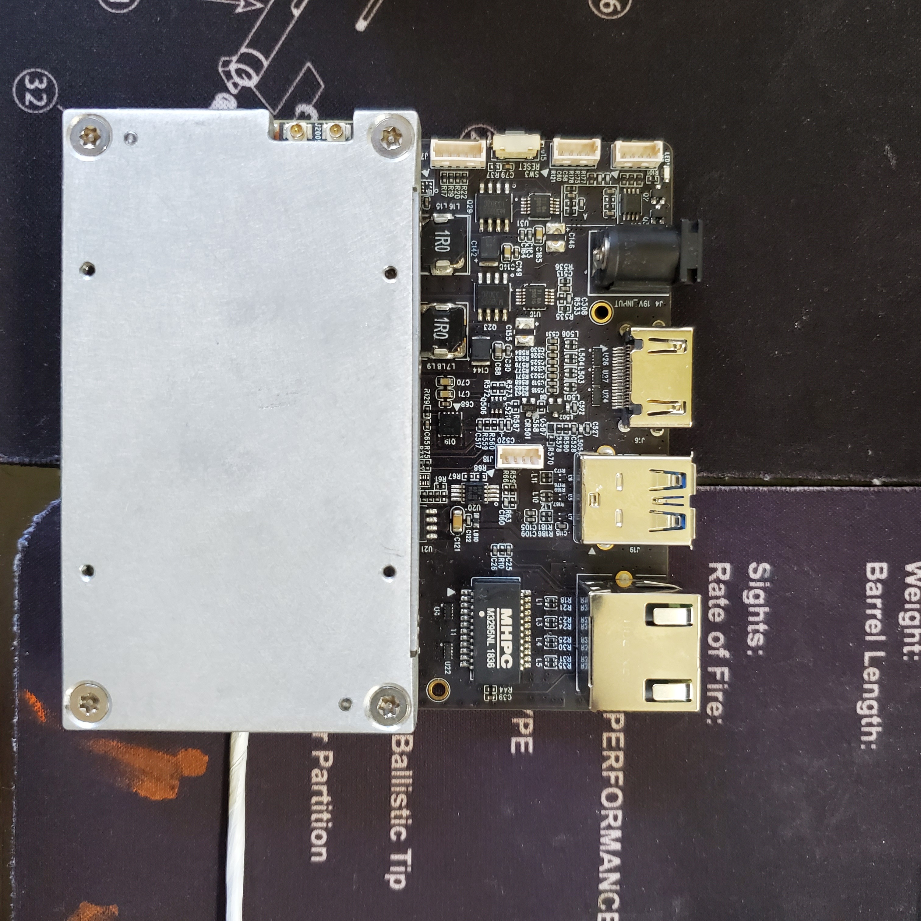

I just flashed by Jetson TX2 to R32 Rev2.3 and now my board is unresponsive after boot. ! I am unable to use the keyboard and mouse, no response from OS, and can no longer see the device via lsusb. I can see it on the local network via the wired network connection. I am also unable to SSH or access the device in any way from the host. I have attached two images. One is of the scree the Jetson freezes on, I suspect it is not frozen rather it won’t take input from most and keyboard. I also added a figure of errors on startup. They suggest the USB port is unresponsive? That makes no sense to me since I flashed it via the USB cable and micro-usb port. I would really appreciate some suggestions on how I can either get the Jetson working again or somehow reset it.

Is the host a VM? I am guessing not, but have to ask. Also, is this on a developer kit carrier board, or is it a third party carrier board? At the location where you flashed from on the host PC, how much disk space do you have? One way to see disk space and filesystem type:

Every module mandates some sort of carrier board, either from the development kit carrier board or some other board (the first image of that URL is a module, the second image is a module mounted to a development kit carrier board), so I may just be wording things badly and causing confusion. The module all by itself is not intended to flash or boot. If the module is bolted down to a circuit board with connectors, then you have a carrier board.
Some carrier boards route different UARTs in different ways (or leave some UARTs unconnected). If your module is mounted to another board, then you have a carrier board, and it would be important to know what the specific carrier is when trying to debug (different carriers require different firmware/device trees). Do you have the development kit? Or a lone module? Procedures vary dramatically depending on the carrier board, and I suspect that you have a development kit (if we make that assumption and it isn’t correct, then figuring it out will be rather difficult). This earlier statement is why I asked about a third party carrier board:
I currently only have a module. It was provided by a client who wants me to add some machine vision software to it. I am receiving a new developers kit tomorrow but it would be very good to get this current module working. I am assuming I can plug it into the developer meant board when it comes BUT it currently has a Leopard camera connected to the bottom of the board. I hope its ok but I have added some pictures that show you what I currently working with.
Thank you
The board this bolts to is your carrier board, and is definitely not the development kit carrier board. This implies you need firmware specific to that board for boot to work. Typically this means taking the flash software used for development kit flash, and copying some custom files in place (adding or replacing some of the boot related content).
Do you have a model number or reference to the part of the PCB with the HDMI/USB/ethernet connectors? If you do, then you’ll be able to search from that manufacturer for firmware (which will be tied to a particular L4T/JetPack/SDK Manager release).
Ill look other wise I have to reach out to the people who sent it over. Thank you for pointing this out. I am new to this and appreciate the education.
this is it. the model and rev were on the back. https://www.leopardimaging.com/uploads/LI-TX1-CB_datasheet.pdf
i think i see were a UART connection is for serial interface which is J17 but again i am not a hardware person so I am not sure.
