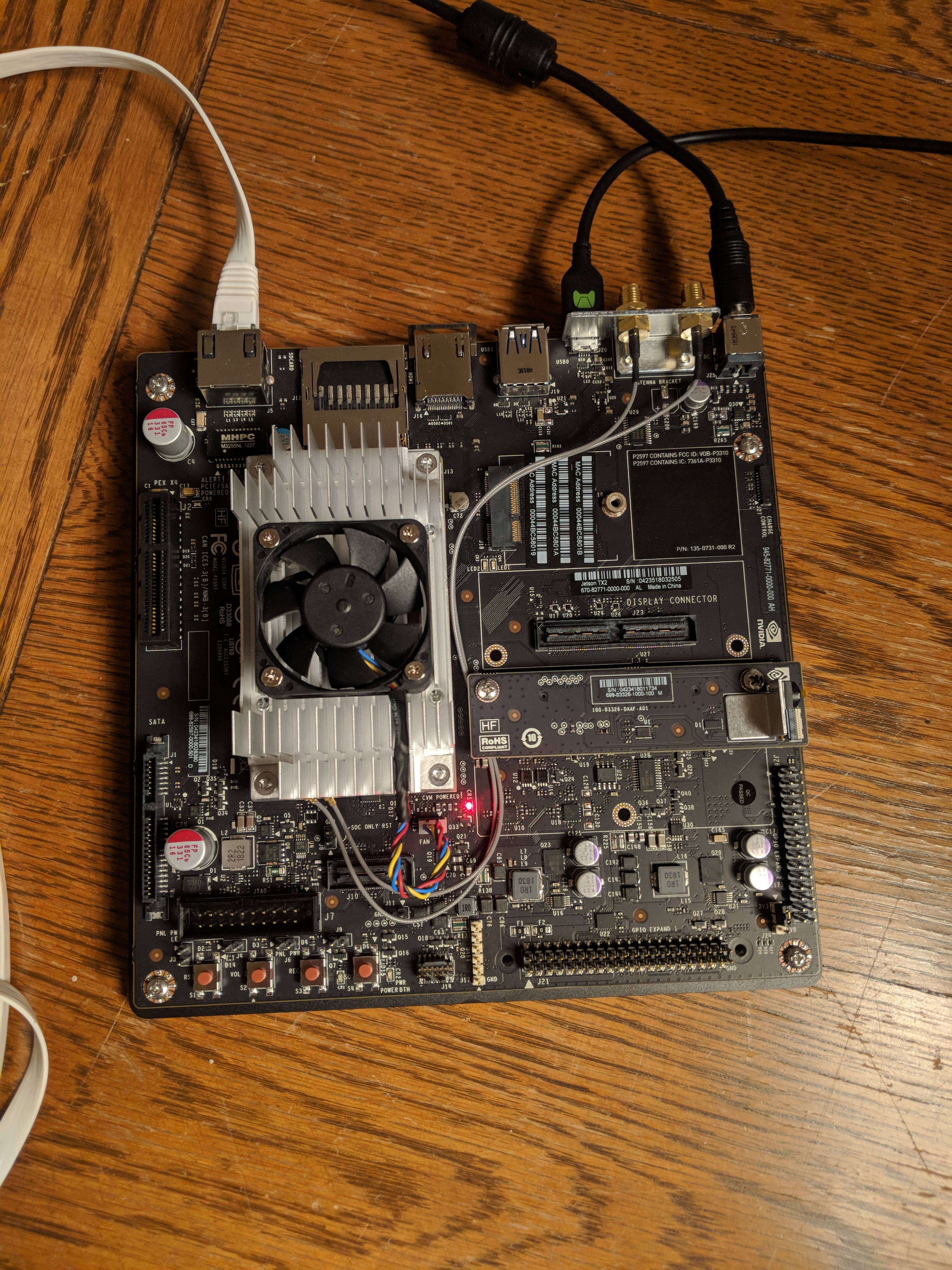

Can someone from NVIDIA suggest what USB 0955:7020 really is? Can you post a picture of the module and/or carrier? FYI, if you hover your mouse over the “pencil” icon in the upper right of an existing post it’ll allow you to edit…but instead of clicking the pencil, notice that a paper clip icon also becomes visible. The paper clip is how you’d attach a file to that post.
Heres a photo of the board and the box.
It certainly looks like any other TX2 dev board. I am wondering if the module itself isn’t really an “ordinary” TX2. Unfortunately, I don’t know enough about it to look at markings to find out if it is really a TX2i or 4GB TX2 (neither should arrive on a dev carrier board though).
Many people are out for the holiday though, but hopefully someone will see this and be able to comment.
Seems to me it doesn’t look like a TX2i, but a 4GB TX2 may explain the 7020 id.
Someone from NVIDIA may tell more abouth this code.
