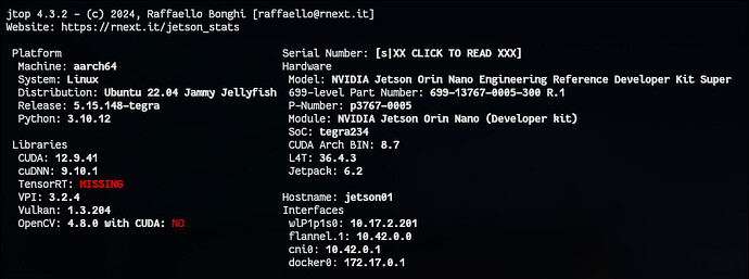

I did follow the provided link to upgrade CUDA from 12.6 to 12.9, the process seems to have been successful from an installation package perspective but nvidia-smi keeps returning 12.6 as CUDA version.

root@jetson01:~# env | grep -E "(PATH|LD)"
LD_LIBRARY_PATH=/usr/local/cuda-12.9/lib64:
PATH=/usr/local/cuda-12.9/bin:/usr/local/sbin:/usr/local/bin:/usr/sbin:/usr/bin:/sbin:/bin:/usr/games:/usr/local/games:/snap/bin:/usr/local/bin
root@jetson01:~# nvcc -V
nvcc: NVIDIA (R) Cuda compiler driver
Copyright (c) 2005-2025 NVIDIA Corporation
Built on Wed_Apr__9_19:30:24_PDT_2025
Cuda compilation tools, release 12.9, V12.9.41
Build cuda_12.9.r12.9/compiler.35813241_0
root@jetson01:~# nvidia-smi
Tue May 27 17:47:24 2025
| NVIDIA-SMI 540.4.0                Driver Version: 540.4.0      CUDA Version: 12.6     |
| GPU  Name                 Persistence-M | Bus-Id        Disp.A | Volatile Uncorr. ECC |
| Fan  Temp   Perf          Pwr:Usage/Cap |         Memory-Usage | GPU-Util  Compute M. |
|                                         |                      |               MIG M. |
|   0  Orin (nvgpu)                  N/A  | N/A              N/A |                  N/A |
| N/A   N/A  N/A               N/A /  N/A | Not Supported        |     N/A          N/A |
|                                         |                      |                  N/A |
| Processes:                                                                            |
|  GPU   GI   CI        PID   Type   Process name                            GPU Memory |
|        ID   ID                                                             Usage      |
|  No running processes found                                                           |
I too am on cuda-12.9 and nvidia-smi also shows cuda version 12.6. I think I remember reading one post where Nvidia said, and I just looked and the nvml

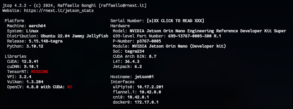

Here is what mine looks like:
Hello, NVML does not support (or does not fully support) Jetson devices, I suspect it is due to GPU architecture reasons (integrated GPU); The statement that the displayed CUDA version for the nvidia-smi command is the maximum CUDA version supported by the current driver is also aimed at general-purpose devices such as Geforce, and due to GPU architecture reasons, jetson devices adopt different upgrade strategies (cuda-compat) to keep up with the pace of CUDA upgrades. I guess the information of the nvidia-smi command has little significance for jetson devices; But Nvidia officials did not directly answer my question on the forum
