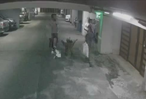

1- Deep stream also use such way: copy from NVMM buffer into CPU buffer?
Because input rate is 25 and output rate is 10, and this cause bottleneck and gradually increased the memory, How to solve this problem? Of course, If I set leaky=2(drop old buffers) in queue, this problem solved but the decodes frames after a while incorrected, but when I set leaky=0(no leakage) that problem solved but start to increased gradually.
original frame:
decoded frame:

The issue looks to be in videorate. If your source is 30fps, the setting in videorate is 10fps and 1 second content will be played in 3 seconds. So the video frames get piling up. You can try nvv4l2decoder and configure
drop-frame-interval : Interval to drop the frames,ex: value of 5 means every 5th frame will be given by decoder, rest all dropped
flags: readable, writable, changeable only in NULL or READY state
Unsigned Integer. Range: 0 - 30 Default: 0
