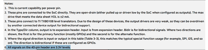

The pins from 40-pins header should be 3.3V since there’s level shifter on the board already.
If you need 5V for the pin, maybe you need additional level shift for your use case.
But from the Jetson Orin Nano GPIO pins, we are getting only 1.8 volts. The controller we are using requires 3.3 or 5 volts from the GPIO pins to respond properly
If the Jetson Orin board really has a built-in level shifter, then why are we getting only 1.88 volts from the GPIO pins?
Do you mean that you get 1.8V rather than 3.3V from 40-pins expansion header?
Please refer to the following part captured from Jetson Orin Nano Developer Kit Carrier
Board Specification/
Maybe that level shift does not exist in your custom carrier board(Tanna Techbiz)?
