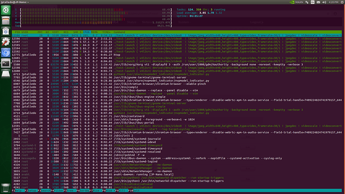

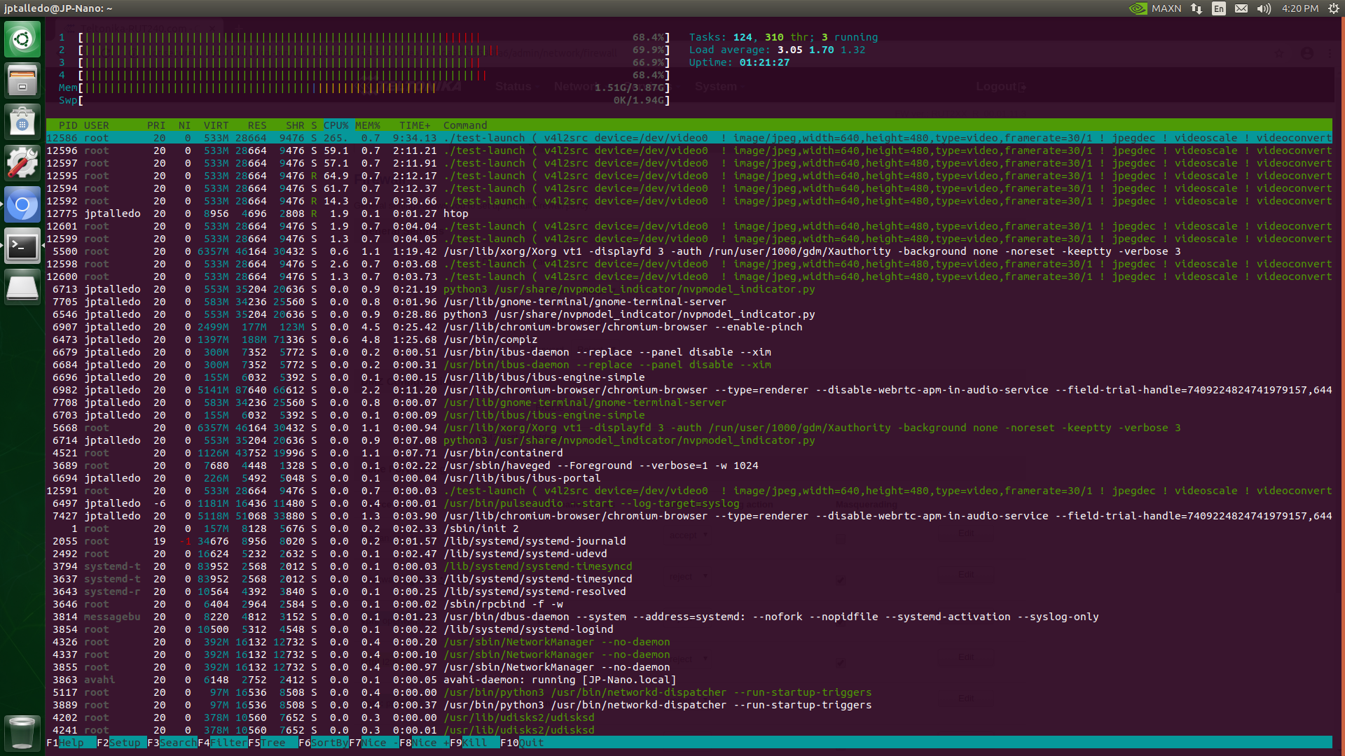

Just checking how I can find/measure the lag? and Do you think if I use a Camera on the NVIDIA camera port will improve results?
I am using a JETSON Nano and the CPU ussage is pretty much high.
Sorry if my advice has not been successful so far…be aware that I have no Nano nor MJPG USB camera for trying, so this is just general advice and pure speculation. Someone with right hw may better advise.
I think CPU usage is heavy because you are using CPU plugins such as jpegdec and x264enc. You would try to use HW JPG decoder/H264 encoder with :src -> image/jpeg, format=MJPG, framerate=30/1 -> nvv4l2decoder mjpeg=1 -> video/x-raw(memory:NVMM), format=I420, framerate=30/1 -> nvv4l2h264enc -> video/x-h264, stream-format=byte-stream, framerate=30/1 -> ...
The simple answer I can give here is using a terminal displaying time in a loop:
while true; do date +%s.%N; done
and have camera recording it.
Then have a rtsp client gstreamer pipeline displaying in the same display (or scene). Make a screen or scene shot and compare times. Be aware it has jitter and average several measurements. Not sure what are the flaws with this methodology. Some better skilled user may further comment.
Not sure again, but I think that MJPG cameras on Nano may have USB hub/bandwith issue.
So using a CSI camera might avoid this.
