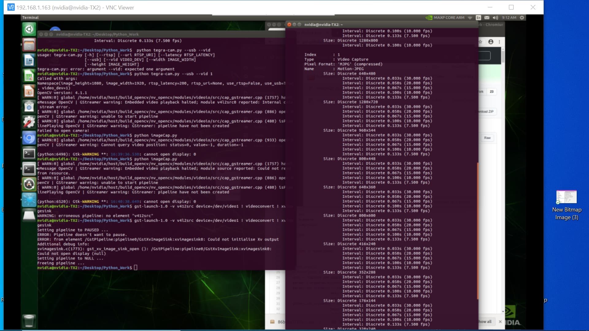

I’ve attached a couple of screen grabs that have the error from:
gst-launch-1.0 -v v4l2src device=/dev/video1 ! videoconvert ! xvimagesink
and the output of the listed formats.

None of the next 3 commands worked.
I got this output:
New Bitmap Image (4).bmp (621.3 KB)

I’m a bit confused… What succeeds here uses /dev/video0, while you mentionned video1 previously.
If your cam is /dev/video0, you may adjust device property of v4l2src plugin.
welp. i’m an idiot. yes.
gst-launch-1.0 -v v4l2src device=/dev/video0 ! image/jpeg, format=MJPG, width=640, height=480, framerate=30/1 ! nvv4l2decoder mjpeg=1 ! nvvidconv ! xvimagesink works … guh.
