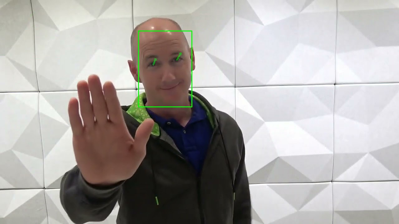

Then, I’d like to run with this gazenet_onnx.etlt like below.
Question:
Could you tell us where can get the source code/project of this Gaze Estimation demo like below?
GitHub - NVIDIA-AI-IOT/gesture_recognition_tlt_deepstream: A project demonstrating how to train your own gesture recognition deep learning pipeline. We start with a pre-trained detection model, repurpose it for hand detection using Transfer Learning Toolkit 3.0, and use it together with the purpose-built gesture recognition model. Once trained, we deploy this model on NVIDIA® Jetson™ using Deepstream SDK.
We would appreciate if you tell us the recommended way to realize this gaze demo on Jetson with our “gazenet_onnx.etlt”.

The official way to realize the gaze demo can be followed via Requirements and Installation — Transfer Learning Toolkit 3.0 documentation and then TLT CV Inference Pipeline Quick Start Scripts — Transfer Learning Toolkit 3.0 documentation and then Running and Building Sample Applications — Transfer Learning Toolkit 3.0 documentation

If there are deepstream app source code of this gaze demo like below, please share us.
