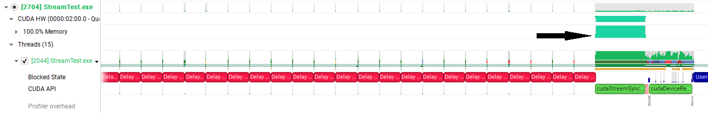

When I run on different CPU platforms, I have different behaviors:
platform1: QuadCore Intel Xeon E5-1620 v4, 3800 MHz (38 x 100)
platform2: QuadCore Intel Xeon E3-1270 v5, 4000 MHz (40 x 100)
The two platform have the same graphics card (nVIDIA Quadro RTX 4000), the same operating system and drivers.
Use Nsight to observe the running status:
platform1:
download
The running process of platform1 is the expected way, and every asynchronous copy instruction will be followed by an actual transmission behavior. However, there is something wrong with the running of the code in platform2. There is no actual transmission behavior after every asynchronous copy instruction is issued, and the transmission does not start until cudaStreamSynchronize.
At the same time, I also found that the query results of asyncEngineCount attribute value of graphics card on two platforms are different.(platform1 is 2, platform2 is 6)
I want to know why this is the result. If I want my program to execute in the way of platform1, what should I pay attention to when choosing CPU?
Which are?
Microsoft Windows 10 Pro 10.0.19044.2130 (Win10 21H2 November 2021 Update)
The graphics card driver is the latest version of nvidia : Quadro RTX 4000 (517.40) WHQL
Do both systems have the same setting for hardware accelerated GPU scheduling?
Thank you for solving my problem. I checked this setting of the two systems, and it’s really different. E3 platform did not turn on this setting.
