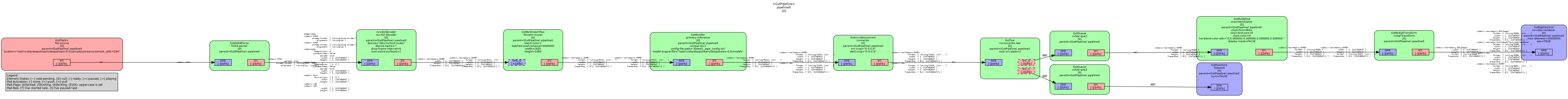

  1. First, we need to create a pipeline like below:
Core part of above image:

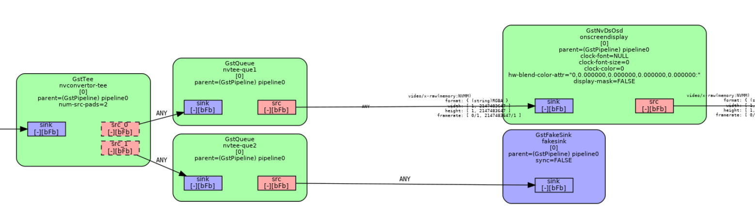

So, I tried to create tee after nvinfer and gsdvideoconvert, before osd. For one queue, it is connected to osd, and the other queue is connected to Appsink. Property of the second queue is 2, with parameter Leaky.
  1. Next, inside function new_buffer, which is connected by Appsink: appsink.connect("new-sample", new_buffer), I tried to write some delays, in order to simulate the situation where heavy calculations inside Appsink.
  2. Probe function is created towards osd: osdsinkpad = nvosd.get_static_pad("sink"); osdsinkpad.add_probe(Gst.PadProbeType.BUFFER, osd_sink_pad_buffer_probe, 0).
There are some details missed, but I will paste all codes below. I would expect to see real time video displayed in local screen. But it is not, after I tried many times.

Hi @zyctimes , thanks for your debugging method, cause it may take some time to anylize your 3 topics, we will infer you as soon as we have a conclusion .
Hi @zyctimes , about the block problem, it may be determined by the Gstreamer’s architecture. You can refer the link below:
https://gstreamer.freedesktop.org/documentation/application-development/advanced/pipeline-manipulation.html?gi-language=c#data-probes
We use the GST_PAD_PROBE_TYPE_BUFFER type probe function, and the Gstreamer official recommendations are as follows:
Data probes run in the pipeline's streaming thread context, so callbacks should try to avoid blocking and generally, avoid doing weird stuff.
Doing so could have a negative impact on the pipeline's performance or, in case of bugs, lead to deadlocks or crashes.
More precisely, one should usually avoid calling GUI-related functions from within a probe callback, nor try to change the state of the pipeline.
An application may post custom messages on the pipeline's bus to communicate with the main application thread and have it do things like stop the pipeline.
Hi Yuweiw:
Thanks a lot for your reply. I could understand what you mean. If logics inside probe function is too complex, it will influence the pipeline performance. Thus, I tried three ways to see whether we could use appsink, multiple probes, or threading to help the block problem of probe function.
My conclusion after test is: appsink and multiple probes will not help, but threading works. I am afraid it is difficult to explain why appsink and multiple probes do not work based on your reference of Gstreamer official recommendations. But from your experience in Deepstream, do you think three conclusions above are correct? Thanks a lot for your help.
Hi @zyctimes ,From the Gstreamer official recommendations about tee plugin:
https://gstreamer.freedesktop.org/documentation/coreelements/tee.html?gi-language=c#tee-page
If you use a queue plugin, the two braches after tee will not affect to each other. So I think one brach may be affect the Clock of the pipeline.
Could you just do a simple test to set the “async” property to FALSE for nveglglessink plugin?
sink.set_property('async', False)
Hi @yuweiw :
Sorry for my late reply. I tried to set sink.set_property('sync', False) in appsink and multiple probes cases (async does not work, but sync works), the performance is improved, but the problem is still there.
So, I still set a time delay with 1 second (time.sleep(1)) in appsink, or another probe in another tee branch. Before adding this line of code, local video display is totally in a still frame. After adding this line of code, I can see local video is displayed with 1 second 1 frame.
I am wondering whether there are some other parameters need to set. I will also have some tries and update in the messages below. Thanks a lot for your help.
Best
Yichao
I also tried to change the value of batched-push-timeout of streammux and qos pf sink. But did not see difference.
streammux.set_property('batched-push-timeout', int(1000000/25))
sink.set_property("qos", False)
Hi @zyctimes , The tee plugin just splits data to multiple pads. It doesn’t copy data.
So if your plugin doesn’t copy data after tee, all the braches are sharing the same data. If you process the shared data in one branch, it will stuck the other branch too. If you want the braches don’t affect to each other. You can try to test your demo by copying the gstbuffer data after the queue plugin. Thanks
Hi @yuweiw, your comments should make sense. However, after my test, results still are same. What I did is:
In the multiple probes cases, for one probe, I just keep the codes same as original deepstream_test_1.py file, for the other probe, I only add a time delay inside:
def fakesink_pad_buffer_probe(pad,info,u_data):
    time.sleep(1)
    return Gst.PadProbeReturn.OK
The local video display still show the one frame per second.
And, what do you mean splits data to multiple pads? Split data with 50-50?
Best
Yichao
Hi @zyctimes , No, it does not really split the real data. If you know about C program, you should know the concept about pointer. No matter how many braches there are after tee plugin, there only has one real data if you don’t copy the data deeply . So you are operating the data in one branch, it may affect the other. We suggest you learn something about the ‘deep copy’ and ‘pointer’ concept.
Hi @yuweiw, Umm, I know what you mean deep copy… I tried copy and deepcopy. Both doesn’t work. I will not continue trying then. If anyone who are interested in this topic, I have pasted all the codes related in the beginning, and you could have a try. Currently the result after I tested is: appsink and multiple probes will not help, but threading works. Feel free to add comments below if you found something different.
Hi @zyctimes , OK, Thanks for your trying.We will add this topic to the QA later. If anyone want to certify this, they can have a try.
