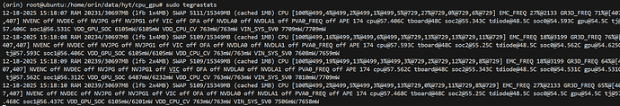

I’m very sorry, but I’m currently running some experiments where I’ve modified the CPU and GPU governors and locked their frequencies. Unfortunately, I can’t stop the experiments immediately, so the output of the command sudo nvpmodel -q --verbose might appear abnormal.
$ top
$ sudo tegrastats
$ sudo nvpmodel -q --verbose
The current reading looks good to me as the python is running with CPU0 99%.
Please share them again after you finish the experiment so that we can check the original issue.
You can run them in the console and share me with a file instead of screenshot.
Yes, I used taskset to pin the task to CPU0.
I’ve saved the output of different commands into separate files.
I have noticed an abnormal phenomenon: when I fixed the frequency, I set both the CPU and GPU governors to userspace. After the task execution was completed, I restored the CPU governor to schedutil and the GPU governor to nvhost_podgov. However, I found that the CPU and GPU frequencies were still running at their maximums, even when there was no load at that time.

No, it does not affect the selection, but it restricts the execution.
While the NVP Model usually doesn’t change which governor is selected(e.g., it keeps schedutil), it strictly dictates the operating boundaries (Minimum and Maximum frequencies).
Please refer to the following lines that the frequencies for both CPU and GPU have been specified in NVP model config.
NVPM VERB: PARAM CPU_A78_0: ARG MIN_FREQ: PATH /sys/devices/system/cpu/cpu0/cpufreq/scaling_min_freq: REAL_VAL: 2188800 CONF_VAL: 729600
NVPM VERB: PARAM CPU_A78_0: ARG MAX_FREQ: PATH /sys/devices/system/cpu/cpu0/cpufreq/scaling_max_freq: REAL_VAL: 2188800 CONF_VAL: 9223372036854775807
NVPM VERB: PARAM CPU_A78_1: ARG MIN_FREQ: PATH /sys/devices/system/cpu/cpu4/cpufreq/scaling_min_freq: REAL_VAL: 729600 CONF_VAL: 729600
NVPM VERB: PARAM CPU_A78_1: ARG MAX_FREQ: PATH /sys/devices/system/cpu/cpu4/cpufreq/scaling_max_freq: REAL_VAL: 2188800 CONF_VAL: 9223372036854775807
NVPM VERB: PARAM GPU: ARG MIN_FREQ: PATH /sys/devices/platform/17000000.gpu/devfreq_dev/min_freq: REAL_VAL: 930750000 CONF_VAL: 0
NVPM VERB: PARAM GPU: ARG MAX_FREQ: PATH /sys/devices/platform/17000000.gpu/devfreq_dev/max_freq: REAL_VAL: 930750000 CONF_VAL: 9223372036854775807
That’s why you got the following behavior.
Sorry, I mistakenly thought that schedutil would automatically adjust scaling_min_freq and scaling_max_freq. After manually resetting them, everything worked fine.
