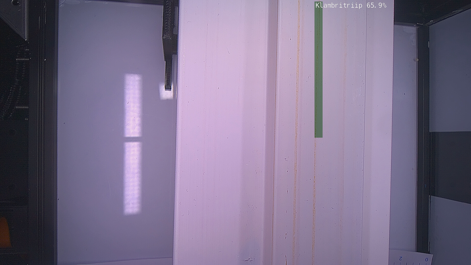

I added some pics also - maybe it is interesting for you. At the moment I’m struggling how to detect those negative light gray stripes (marked green):
Just for illustrations:
In the model setup, SSD-Mobilenet-v2 uses the same config as SSD-Mobilenet-v1, so I think it is 300x300: https://github.com/dusty-nv/pytorch-ssd/blob/21383204c68846bfff95acbbd93d39914a77c707/train_ssd.py#L238
You may be able to add config.set_image_size(args.resolution) to here so that SSD-Mobilenet-v2 responds to the --resolution command-line argument, but I’m not sure.
I’m curious that when you said SSD-Mobilenet-v2 was performing extremely well, did you mean that it was more accurate? My benchmarking showed the runtime performance to be basically the same as -v1, but I didn’t try this scenario with small objects. You objects seem to have a very small aspect ratio (i.e. height is much greater than width) and I’m not sure what tweaks you could make to the SSD anchors/priors to help with that but I’m guessing some additional experimentation could tell.
thnx
thnx that you are “in topic”, i mostly do this project alone. it has been great help.
I guess that beginners and dumb users as i are lucky :) - I think, the case was that before I used SSD v1, I changed the settings and later trained with v2 and didn’t know that it uses the same conf (but i thought couple of times if it was configurable) - so, my “old v1” settings gives better resolution and v2 gives accuracy and better detecting:

Dusty, I completed the test, here is some training graphs:
And here is some real-world detection test:
So - in case i havent made any mistake then v2 is better while detecting…
