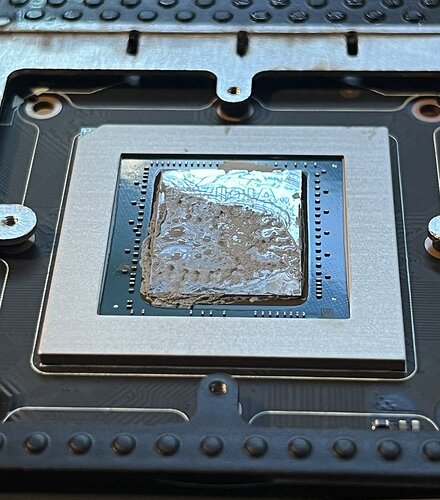

Likely a thermal problem with local overheating before the temp sensor is catching up. I fixed it with re-applying thermal paste to the chip. It was dry as a brick and covered only half the chip.
