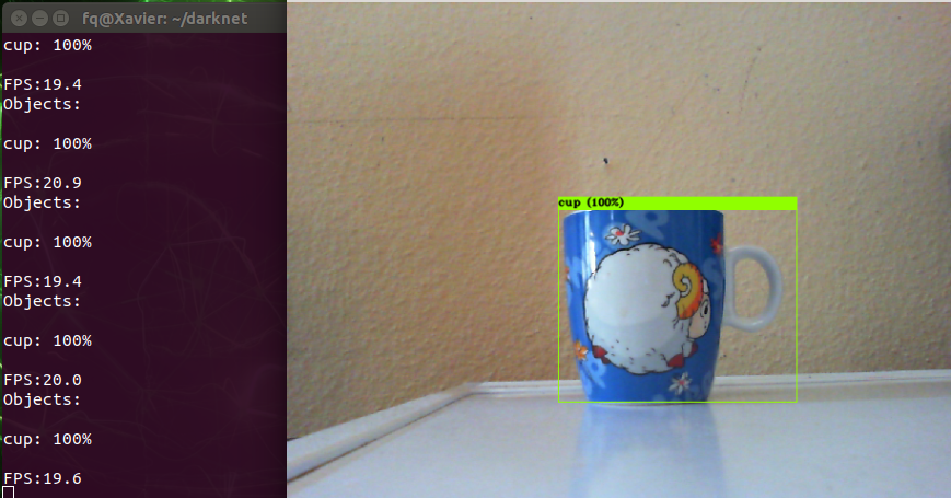

Now I want to point back to my initial question, which was to reach higher fps with YOLOv3 on the AGX.
YOLOv3 runs with deepstream at around 26 FPS. I varied the network size to 416, 320 and 160. All gave the same FPS (please see attached picures).
Could it be, that maybe I missed to change something in the .cfg file, in config_infer_primary_yoloV3.txt or in deepstream_app_config_yoloV3.txt. (See also attached files)
In comparison if I use darknet, changing the input size brings a huge difference in the output FPS. When I use 416, YOLO reaches around 20 FPS. But when I reduce the size to 320, YOLO reaches around 27 FPS and with an input of 160 it reaches 31 FPS. (see also attached files)
Do you have an idea what I could have done wrong, because right now, I don’t see any improvement of using Deepstream instead of Darknet.
Thanks again!

Please remember to delete the previous TensorRT engine file.
TensorRT will convert the YOLO model into TensorRT engine when the first-time launch.
To save compiling time, the generated engine will be serialized into disk for the next time launch.
So if you update the network architecture, please make sure to compile the engine from the model rather than de-serializing.
The easiest way is to delete the engine file each time you launch a new architecture.
model-engine-file=model_b1_int8.engine
