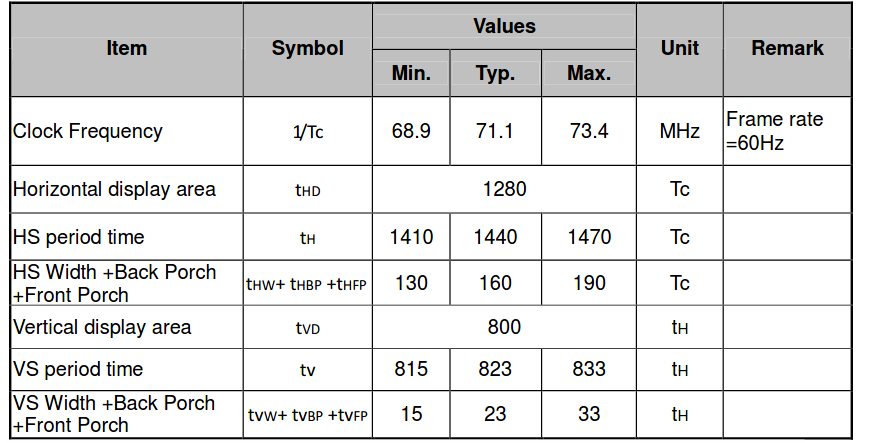

I am not sure this would help, but we have the display timings for the LCD panel,
Our display driver has a calculation to filter them.
Is it possible to tell us whether the NX will support these timing parameters? The thing is we are designing a custom carrier board, we are looking for some assurance that this display will work on our carrier board.
Also please share if you know any other way to confirm this other than testing with the actual carrier board.
Cheers.
Sorry that I won’t help you do the calculation here. But you could refer to the driver code. Please download the kernel src from dlc.
/kernel/nvidia/drivers/video/tegra/dc/dp.c
-> tegra_dp_mode_filter
/kernel/nvidia/drivers/video/tegra/dc/mode.c
->check_nvdisp_mode_timings
