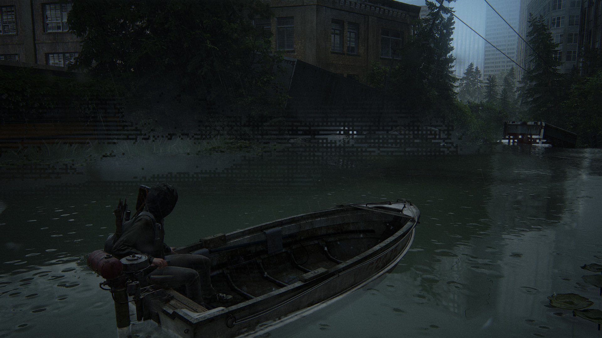

Can also confirm the weird grid issue and crashes in TLoU2
Jan 02 16:19:54 arch-desktop kernel: NVRM: Xid (PCI:0000:01:00): 109, pid=3424, name=tlou-ii.exe, channel 0x0000005d, errorString CTX SWITCH TIMEOUT, Info 0x8c073

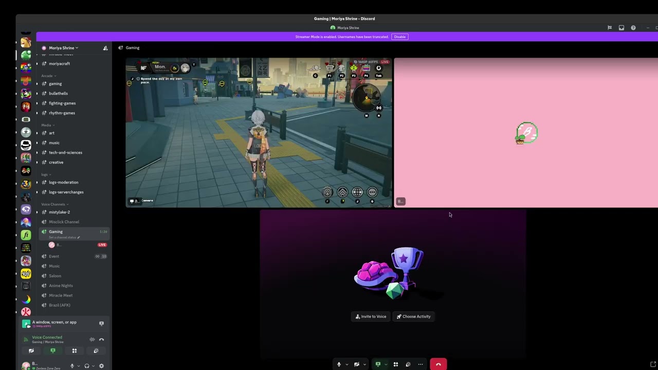

@aplattner Has this issue been resolved yet? This bug is driving me nuts. I would suggest the Linux Driver team fix this issue on GNOME please while streaming on discord

Dear Magigamix,
We have root caused this issue and it is Freon utility bug, and the details are captured at https://github.com/UshakovVasilii/gnome-shell-extension-freon/issues/306

please fix my gnome screen sharing issue

Hi @redhatwattana
Did Gnome screen sharing worked on previous drivers ?

I just moved to GNOME recently so I am not sure. I have seen that my friends who used GNOME also have issues like this going on.

Hi I have this issue as well and know another person who has it as well. All on GNOME. This has been an issue for several driver versions now and is nothing new. Though I think it wasn’t always the case but I am not sure when it started.
