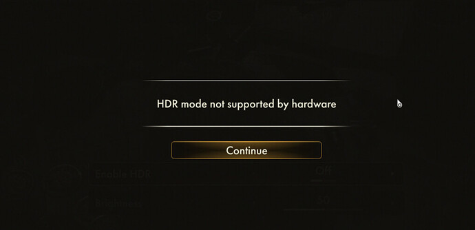

Indiana Jones and the Great Circle
- RTX 5080 (PC): The game rarely launches successfully. I managed to get it running in āSafe Modeā with default graphics settings. However, after changing the resolution to my monitorās native 3440x1440 and restarting, it failed to launch again. While the taskbar shows the game is running and audio is audible, visually there is only a small flickering square in the top-left corner of the screen.
- RTX 4080 (Laptop): I was unable to consistently reproduce this issue on the laptop; with one exception where it behaved identically to the PC, the game generally works normally.
On both the RTX 5080 PC and RTX 4080 Mobile, HDR cannot be enabled in Indiana Jones. I receive the message: āHDR mode is not supported by hardware.ā This worked previously 15 minutes before on version 590.44.01 on my laptop.
HDR continues to work correctly in other tested titles, including Red Dead Redemption 2, Cyberpunk 2077, and The Witcher 3.
