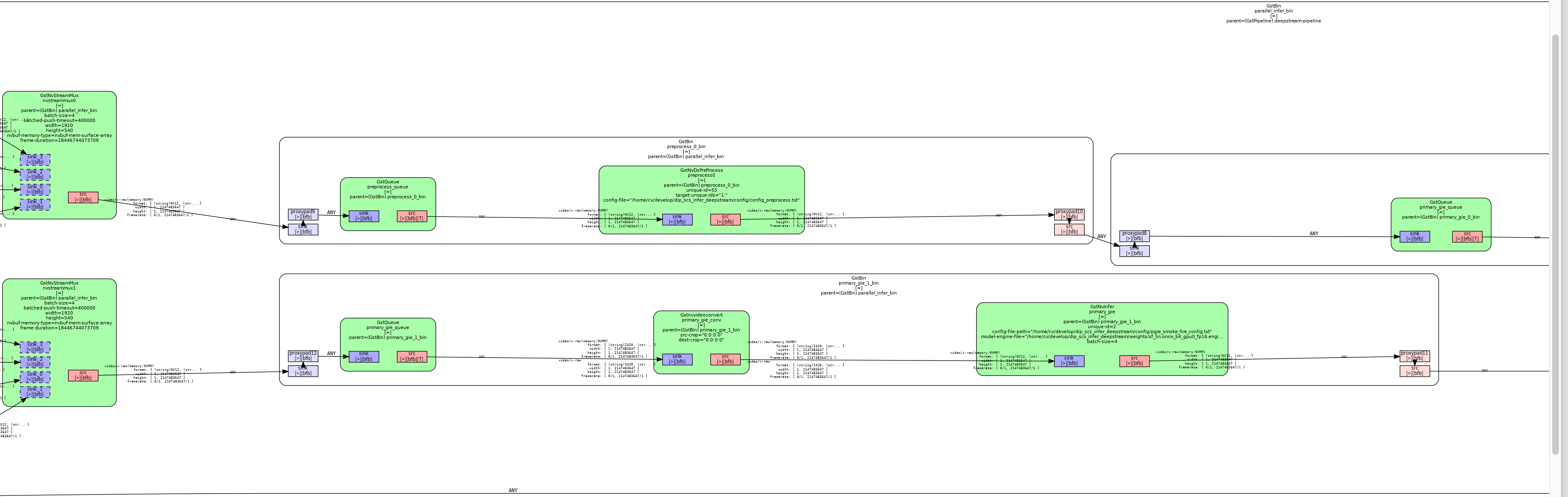

I create my pipeline refer GitHub - NVIDIA-AI-IOT/deepstream_parallel_inference_app: A project demonstrating how to use nvmetamux to run multiple models in parallel., And the pipeline like this
I want to know if primary_gie_0_bin and primary_gie_1_bin synchroized?
For example, assume gie1_bin is run faster, gie1_bin process on 3th batch, but gie0_bin process on 1th batch
All inferencing models work asynchronously. The metamux will synchronize the inferencing results.

Your branch0 and branch1 share the same sources(0,1,2,3), why did you say “only source0 can detect vehicle,”??
Your model 1 and model 2 inference on all 4 sources according to your configuration. Please refer to NVIDIA-AI-IOT/deepstream_parallel_inference_app: A project demonstrating how to use nvmetamux to run multiple models in parallel. (github.com)
I test two models, one is vehicle detection, the other is smoke or fire detection, source (0,1,2,3) is the test case I test vehicle detection, only source0 video has vehicles, source (1,2,3) video has no vehicles, so I say that “only source0 can detect vehicle”.

Why do you use nvpreprocess? Can you provide the graph png image, the graph image you post can not be viewed clearly.
Because I only want to detecet the roi, not full frame.
Can you upload the “PNG” file but not JPEG file? It is too small to view.
How should I upload png, I upload the pipelien.png, size is about 2M, but I don’t know why it will become too small after uploaded
