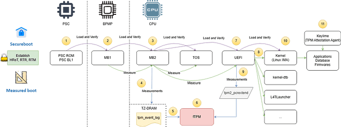

hello arulpandiyan.vadivel,
here’re commands check PCR,
it’s also an example to confirm whether measured boot is active.
for instance,
$ sudo modprobe tpm_ftpm_tee
$ sudo tpm2_pcrread
Thanks for the response, tpm_pcrread does help to show the the PCR Register values,
When we write and read back after reboot it was not updated as expected, Seems like it is getting updated from BootLoader(UEFI) itself upon reboot?

root@orin-nano:~# tpm2_pcrread sha256:7
  sha256:
    7 : 0x65CAF8DD1E0EA7A6347B635D2B379C93B9A1351EDC2AFC3ECDA700E534EB3068
root@orin-nano:~# tpm2_pcrextend 7:sha256=b5bb9d8014a0f9b1d61e21e796d78dccdf1352f23cd32812f4850b878ae4944cread
  sha256:
    7 : 0x272217BBFC9DD898B421D99A968D223AAF30755E13B18872C97BD54602FDAC49
root@orin-nano:~#
After Reboot
  sha256:
root@orin-nano:~#
root@orin-nano:~# cat /proc/uptime
218.36 1264.94
root@orin-nano:~#
please refer to The fTPM Boot Flow and fTPM Measured Boot.
The fTPM boot flow is a process that verifies and measures the integrity of firmware components during the boot process.
it’s hash value to verify the authenticity and consistency of various components within the boot chain.

Is there any utility available from nvidia to update/extend the ftpm pcr registers permanently (not reset from UEFI).
according to the documentation, you’ll need to update the firmware components (such as mb1, mb2, TOS..etc) for changing hash values.
Can you please point me to the documentation how i can update the firmware components?
please refer to developer guide, Flashing Support.
BTW, may I double check what’s the Jetson security you’ve enabled? for instance, did you fuse a target to burn PKC/SBK..etc?
No, We did not have fused the target with PKC and SBK keys
Do you mean to say, PCR hashes will get updated only when flashing MB1/MB2/TOS, It cannot be modified persistently on our own, as the scope of the PCRs are limited to only firmwares as per this boot flow
you may Flashing a Specific Partition to flash a specific partition instead of flashing the whole device by using the command line option -k.
Question for this ticket to update the PCR registers persistently on fTPM
please update the firmware components (such as mb1, mb2, TOS..etc).
since you’re not fusing a target, you may flash a specific partition instead of flashing the whole device.
