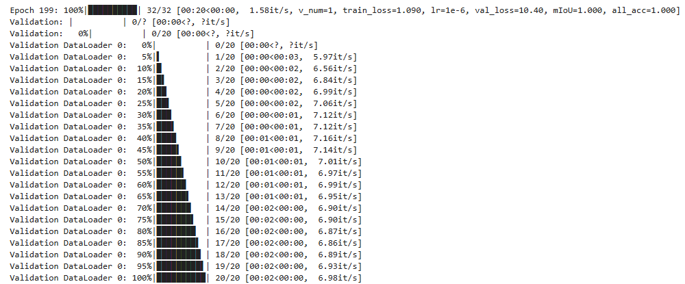

Hello, I’m running into the same issue. I’m training Mask2former on my own COCO formatted dataset with 1 class anywhere from 5 to 200 epochs. I’ve tried a variety of different hyperparameters, and all of them result in mIoU of 1 for all epochs which is making me doubt the training progress.
I’m able to train Mask2former using mmdetection with great results; however, trying to replicate the process on TAO, the performance is falling short and has been disappointing. I’ve attached the relative files for your reference if necessary.
labelmap_inst.txt (130 Bytes)
spec_inst.txt (2.3 KB)
train_annotations.txt (3.2 MB)
Epoch 1
Epoch 200

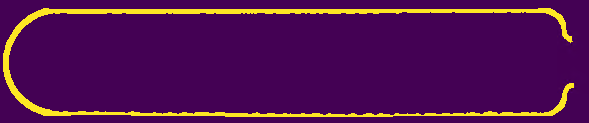

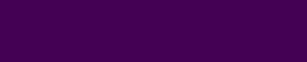

Mine is also the same. I’ve been doing more debugging in the container, and it seems that the model is not learning my “foreground” or non-background pixels at all. When I print the unique predicted labels, I only get [0] and not [0, 1] which is what you expect if the model were to predict both foreground and background. I can confirm this by looking at the segmentation mask input to the model and the predict mask:
Input:
Prediction:
This all makes me think the issue is dataset related or how the pipeline maps the labels to indexes and so forth.
I understand the dataloader expects the COCO format, and I’ve reviewed my dataset to be correct, but I’m not sure if I’ve missed something subtle that is resulting in this behavior. Are you able to verify the attached example validation annotation file for accuracy? Things like categories, the segmentation format, etc.

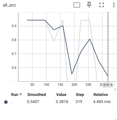

p.s. After changing reduce_zero_label to False I do get a value that is lower than 1; however, it ends up staying the same for all epochs and suddenly dropping for the last epoch. Printing the values during each epoch I get this:
iou [0.9436853 0.       ]
miou 0.47184265
It seems to me that the model is not making any prediction for the second class (which is either the background or foreground in this case), so one value in iou is always 0 now.

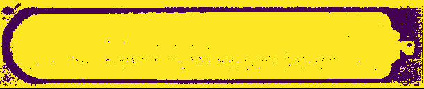

Update: I decided to let the model train for a few more epochs. Strangely, mIoU and accuracy go down as loss values go down
I suppose some good news is that now I can see a mask on prediction; however, another strange finding is that looking at the input segmentation to the model and its prediction, the label values seem to be flipped. Notice how the purple and yellow are flipped in these images.
Input
Prediction
As a reminder, it seems like per mmdetection documentation, for binary segmentations a few changes are needed, but I’m not sure how I can make these changes in TAO. Reference How to handle binary segmentation task in the following repo:
