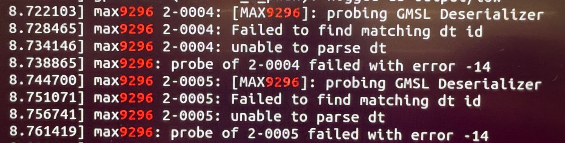

But initializing the MAX9296 chips with the original driver compatible = nvidia,max9296 seems to throw an error since I am unable to get the right i2c address … I have tried `<0x4>, <0x5> and <0x48> but they all don’t see to work. (dmesg log shown)
However, loading this device tree causes the Apex AD10 not to boot (the fan spins up for a long time > 1 minute) and then goes into a restart. If I were to disconnect the cameras, the Apex AD10 would boot fine. I am still trying to get the UART Debug port to work so I can see the boot log but to no avail … (but I will keep trying and post back if I get anything).
