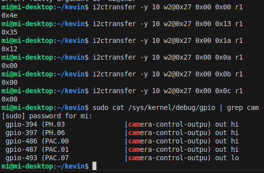

Hi Jerry,
I change the CAM12V_POC(AC.07) value to low, this is the test result, you can see the deserializer’s link status is not locked.
And when I change the CAM12V_POC(AC.07) value to high, the result is same. How would I do? Thx!

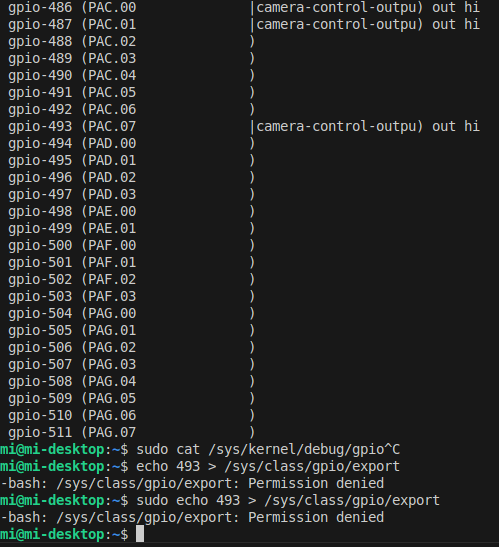

but I have another question about manual config GPIO’s value on linux system for debug, when I excuse the command:
Pls help me to resolve it, thx!

hello Kun_Wang,
you cannot export 493 to debugfs since gpio-493 (PAC.07) is already occupied by camera control.
