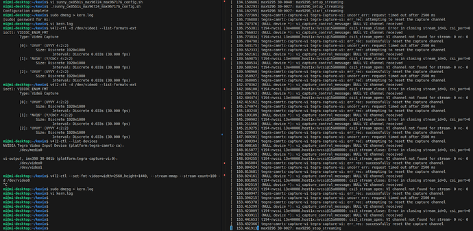

Hi Jerry,
With the ADI FAE support, the max96724 CSI Controller1 has send camera data to orin CSI module, and I have config the port-index correct refer the tegra234-p3737-camera-fzcam-fg12ch-4lanes.dts file. But when I capture by use v4l-ctl command, the VI error again. How can I do to resolve the issue? Thank you!
hello wangkun37,
is the v4l2-ctl list-format report the correct sensor supported formats?
may I know what’s the your test pipeline, and what’s the error messages?
hello wangkun37,
it’s a bad practice for pasting the logs as a picture.
I’ve notice there’s an invalid argument error has reported from your v4l pipeline.
besides, your sensor driver also reporting an error of updating control range.
please debug into your driver side.

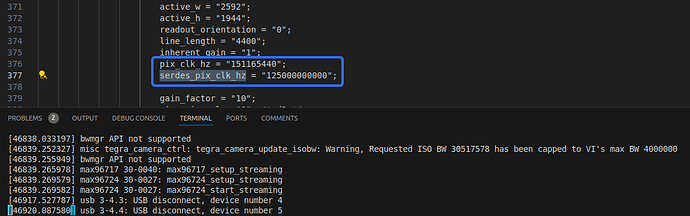

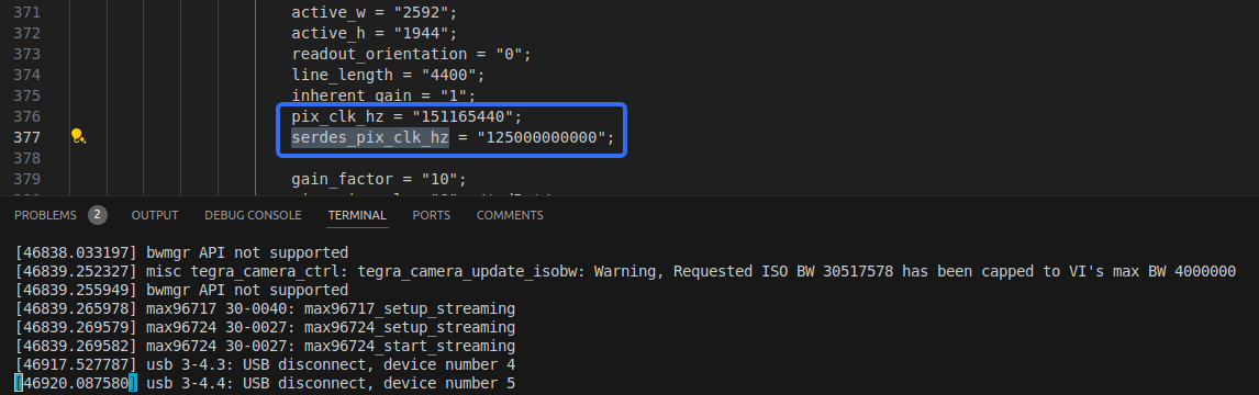

Hi Jerry,
With ADI FAE help, the Deserializer’s ERRB is bandwidth cause, and I optimized the 0x418 register has resolve the ERRB error. And I increase the pix_clk_hz from “74250000” to “151165440” in dtsi file. But I test again, the video 0 and video 1 show different type issue. How can check next? Thank you!
Hi Jerry,
When I change the serdes_pix_clk_hz from “375000000” to “125000000000”, the VI not report error, But when I test preview by gst-launch-1.0 tools, the image is black picture. Please help me analysis it. Thanks!
hello Kevin_Wang2025,
is there a typo? it is 125 Ghz per your settings.
please double check developer guide, SerDes Pixel Clock to evaluate your clock rate.
