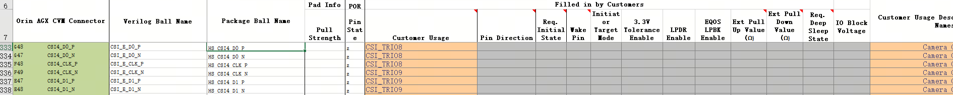

Next I have another question about CPHY test.
I recently tested CPHY on the Orin Dev Kit. The deserializer on the acquisition board hardware is currently only connected to the CSI-E port of Orin, but the port is in DPHY mode by default. I did not find CSI-related keywords in the pinmux.dtsi file generated by the pinmux table. How can I modify it? Thank you.
hello Kevin_Wang2025,
please refer to developer guide, Individual Imaging Devices for the phy_mode
settings.
you may also update those device tree settings accordingly for changing to CPHY.
