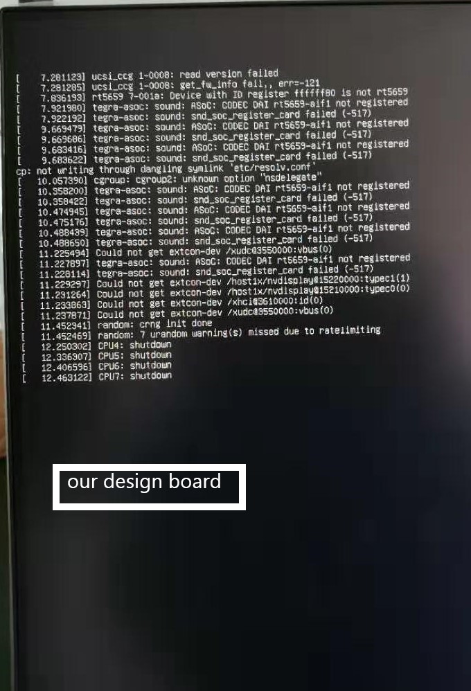

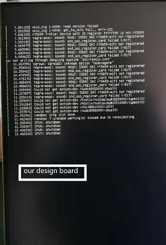

After connecting Xavier with our desined board, all USB interface cannot be used and type-C cannot be used
  1. After connecting Xavier with our designed board, all USB interface cannot be used and type-C cannot be used
  2. when disable Jetson AGX Xavier Developer Kit PD controller‘s I2c shifter, all usb cannot be used;
  3. our designed board remove the PD controller related
    so I think the problem is due to removed the PD controller,How to solve this problem,thanks。

Before today’s test, all functions can be used normally on Xavier and demo board, but I can’t use USB and other interface functions on my own design board
Today, I modified the device tree based on the information I got from Jetson AGX Xavier Platform Adaptation and Bring-Up Guide
Specific operation:
  1. Delete extcon - * attribute under xhci and xudc
  2. In xusb_ pad_ CTL to add a regulator for “VBUS supply”.
My own design board does not have OTG
But when I do this, the demo board and my own design board can’t use the USB interface function
Please tell me how to solve this problem? thanks
