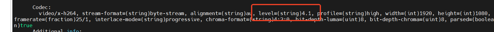

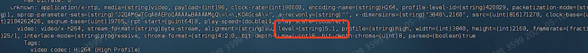

Thank you for your reply. My pipeline program has been applied to analyze multiple RTSP video streams. When I used gst-discover-1.0-v $RTSP_PATH to analyze the detailed information of the video stream (as shown in the figure), I found that my program can only run stably on video streams with encoding level 4.1, and RTSP video streams with encoding levels 5, 5.1, and 5.2 are not working. Do you know what this encoding level means? Can I configure different levels of parsing in the pipeline?
Please refer to the spec document H.264 : Advanced video coding for generic audiovisual services appendix A.3
ok,so Can I configure different levels of parsing in the pipeline?
The 3840x2160 resolution should be level 5.1.
What do you mean by “configure”?
Because I think this level difference affects the stability of the program, is that correct?
No. I think you can google the meaning of “level” if you don’t have time to read the H264 spec document.
The level is calculated from the video resolution.
