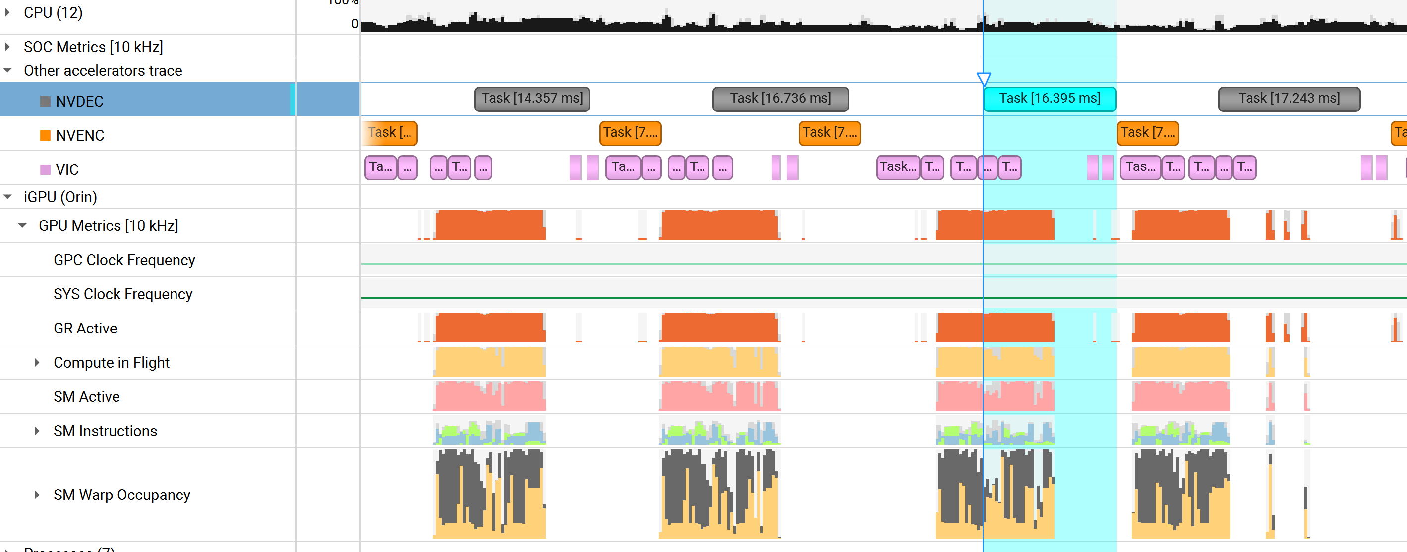

I’m using a segmentation model developed in my project and I’m getting about 50-55FPS. I’d like to understand how I can enhance the performance because I noticed that GPU (through jtop) is used around 20%.
I used Nsight systems to investigate my CPU/GPU usage. I noticed a low GPU average usage (about 20-25%) but I have some trouble to identify what is causing the GPU to be under-utilized → i’d like to identify why the GPU is resting :
The nsight report is around 2Gb.
That’s the first time I’m using nsight so any tips will be welcome. I did watch some webinar on it so I understand how the tool work but I’m unable to draw conclusions.

Could you share more about the model and use case?
Based on your nsys file, the NVDEC takes 16.3~16.7ms seems to be the bottleneck of the pipeline.

The model is a custom segmentation model. The use case is human/object detection.
- Based on your nsys file, the NVDEC takes 16.3~16.7ms seems to be the bottleneck of the pipeline.
Thanks for the analysis.
I’m using a video file for that is encoded in 1080p 30fps (h264).
How can I make it run faster and use less time in decoding ?
Based on our spec here, h264 decoding can reach higher throughput.
Which nvpmodel do you use? Could you maximize the device’s performance and try it again?

Could you also turn off the Triton inference and test the decoding fps separately?

Are you able to measure the time without inference?
Since we originally thought the bottleneck comes from NVDEC, this should not change (~16ms) even if disabling the primary-gie.
