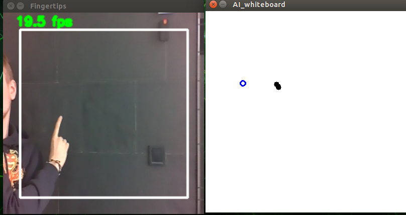

We were then ready to launch our prototype, and obtained the following first results :
Preliminary results
As you can see from the screenshots above, we first faced several issues:
  • Several problems were connected with hand detection . The detector did not work stably enough. In particular, it could not properly detect a hand with only the index finger pointed , though this is a dominant configuration. Also, we faced some issues when moving the hand too far away from the camera (more than one meter) and it is quite uncomfortable to have to set up the system so close to the wall.
  • Another problem was the video processing speed (framerate) - only 12 frames per second (fps) on average. It was not very surprising as the pipeline involves two deep neural networks. Unfortunately, this speed prevented us from getting smooth lines and drawing freely.
