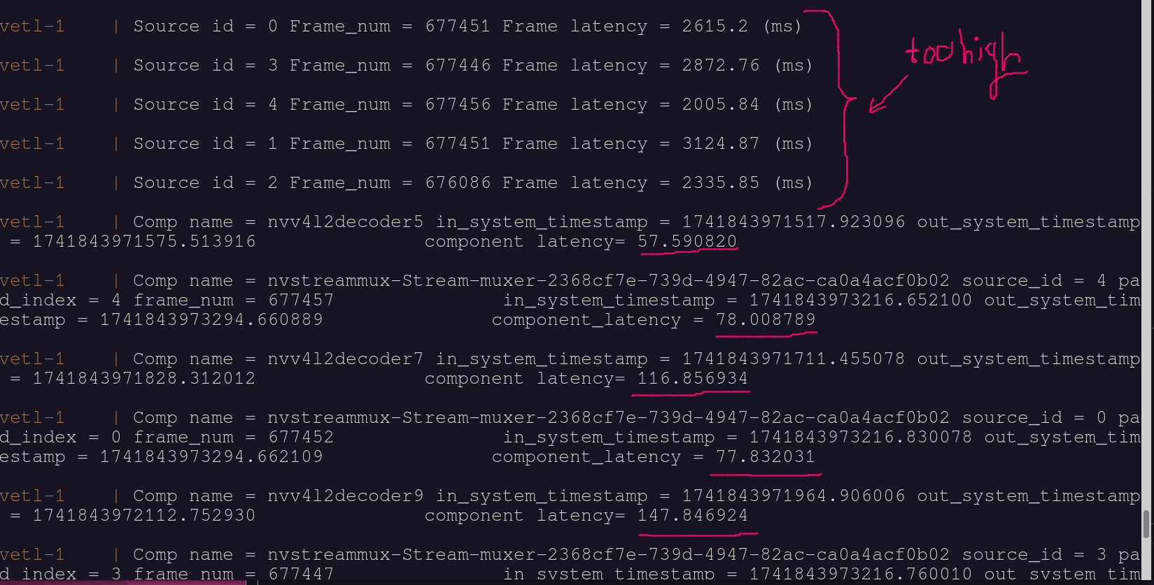

hi i have alot of jitter in this pipeline can you help me in this case? i alse have to say that the latency of element is too low but frame latency is too high ! why this happend

  3. could you share more latency logs? noticing the frame latency is about 3 seconds, but component latency in the screenshot is not high.
