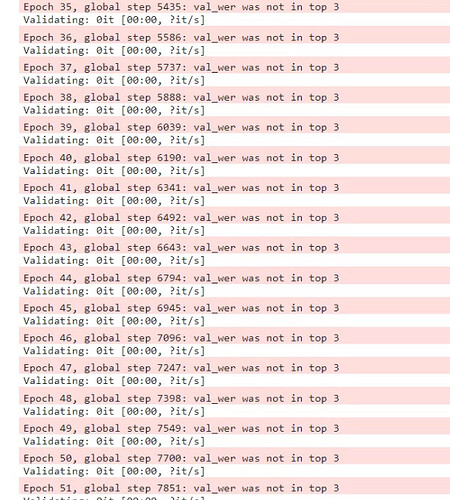

Hi all,
I managed to get my citrinet model down to a val_wer score of 0.17.
However, when i tried further fine tune the citrinet model, the val_wer is fluctating between 0.17-0.19
Was wondering if there are any tips on how to further reduce the wer score as I aim to get it below 10 percent word error rate (0.10)
Here is the configs I used.
Setup train, validation, test configs

Did you use pretrained model?
Yes i used the pre-trained model ‘stt_en_citrinet_1024’
Now it is showing me “val_wer not in top 3”
Which dataset did you train? Is there any baseline?
When there is “val_wer not in top 3”, that means current epoch’s val_wer is not in the top3 best one.
For finetuning, you can try to finetune against more parameters. For example, try lower training batch-size.
I am using my own datasets which are medical transcripts.
I don’t think I have a baseline, I am currently just finetuning the nemo model from the latest checkpoint which has a WER of 17 percent.

I tried using the command listed above but i am still getting “File not found” when loading the validation dataset
Any idea why this is occuring ? I doubt its the pathing as my training set was able to load just fine
The command i used was :
speech_to_text_citrinet finetune -e /workspace/tao-experiments/xd/finetune.yaml -k tlt_encode -r /workspace/tao-experiments/results/ finetuning_ds.manifest_filepath=/workspace/tao-experiments/specs/final/train_manifest.json validation_ds.manifest_filepath=/workspace/tao-experiments/specs/final/val_manifest_fortao.json -m /workspace/tao-experiments/specs/speechtotext_english_citrinet_1024.tlt
Attached below is my error log :

This kind of error is usually due to wrong mapping setting.
Please check the ~/.tao_mounts.json.
Please note that all the path in the commandline should be the path inside the docker.
The path is defined in ~/.tao_mounts.json.
Managed to fix the pathing, is there anyway to specify which GPU to use? the -g option only specifies how many gpus is to be used for finetuning, not which gpu.
Please add below in the beginning of command line.
CUDA_VISIBLE_DEVICES=0,1,2,3
or
or
CUDA_VISIBLE_DEVICES=1
