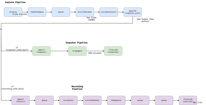

I’m developing a GStreamer application in C on a Jetson AGX Orin (DeepStream version 7.1) and have encountered a freezing issue when trying to use hardware-accelerated JPEG and H.264 encoding simultaneously.
My application needs to capture a single RTSP stream (1280x1024 @ 30fps), and on-demand, be able to:
  1. Record the stream to an MP4 file (using nvv4l2h264enc).
  2. Take a snapshot of the current frame as a JPEG file (using nvjpegenc).
Application Architecture: My C code (attached video_gst.c) implements the following logic:
  1. A primary capture pipeline: rtspsrc ! rtph264depay ! nvv4l2decoder ! nvvideoconvert ! appsink.
  2. The appsink’s new-sample callback receives raw video/x-raw(memory:NVMM) buffers.
  3. For Recording: When recording is started, I create a new pipeline (appsrc ! ... ! nvv4l2h264enc ! ... ! filesink) and push the copied buffers from the main appsink into this recording pipeline’s appsrc.
  4. For Snapshot: When a snapshot is requested, I create a short-lived pipeline (appsrc ! ... ! nvjpegenc ! ... ! filesink), push a single copied buffer into it, wait for EOS, and tear it down.
The Problem:
The application works perfectly when I either only record or only take snapshots. However, if I start recording and then try to take a snapshot, the entire application freezes.
Observations:
  • Software Encoder Works: If I replace the hardware nvjpegenc in my snapshot pipeline with the software jpegenc, the application works correctly. I can record and take snapshots simultaneously without any freeze. This strongly points to a resource conflict on the NVENC hardware engine.
  • Alternative gst-launch Pipeline Works: The following gst-launch-1.0 command, which achieves a similar goal, works without issue:
    gst-launch-1.0 rtspsrc location="rtsp://192.168.10.13:8554/day" latency=0 ! rtph264depay ! tee name=t \ t. ! queue ! h264parse ! qtmux ! filesink location=video_record.mp4 -e \ t. ! queue ! h264parse ! nvv4l2decoder ! nvjpegenc ! multifilesink location=snapshot.jpg max-files=1 -e
My Questions:
  1. Whats the reason for the issue.
  2. Is there a known limitation or expected behavior that prevents two separate GStreamer pipelines from concurrently accessing the NVENC hardware via nvv4l2h264enc and nvjpegenc, especially when fed from the same source?
  3. What is the officially recommended pipeline architecture in C/C++ to decode a stream once and then re-encode it to both H.264 and JPEG using the hardware accelerators?
  4. Is my approach of using multiple pipelines with appsrc/appsink fundamentally flawed for this use case? Would a single, monolithic pipeline using a tee element after the decoder be a more stable approach?
Thank you for your time and any guidance you can provide.

This implementation works with a low-resolution camera feed. If two pipelines are using the same hardware resource simultaneously, it shouldn’t work, right? So, what’s the reason the tee method is working?
Hi @richu.dicortech , The problem might be caused by some of the following actions of yours.
The operation of the gstbuffer must strictly comply with the Gstreamer specifications. If there is any gstbuffer that is not properly released, it will eventually cause the entire pipeline to be stuck.
The tee plugin can handle the splitting and copying of buffers very well. For your scenario, we recommend using tee plugin to achieve it.
Thank you for your replay,
This works fine with the low-resolution camera That confusing me.
so the reason for the issue is not the record and take a snapshot simultaneously, both pipelines are trying to access the NVENC hardware, resulting in a resource conflict and causing the application to freeze.
Hardware JPEG encoder and H264 encoder are individual engines. Should not interfere each other. We would need to replicate the issue on developer kit and check further. Please share a test sample or gst-launch command to reproduce the issue.
Hi @richu.dicortech , on our DS7.1 version, the queue plugin may cause the hardware jpeg encoder to get stuck. Could you try to remove the queue plugin in your pipeline and see if there are any issues then?
This is the snapshot pipline i am using there is no queu in it but it still have the issue.
sprintf(snap_pipeline_str, “appsrc name=snapsrc num-buffers=1 caps=\\\“video/x-raw(memory:NVMM),width=%d,height=%d,format=NV12,framerate=%d/1\\\” ! nvjpegenc ! filesink name=snapsink sync=false”, DAYCAM_WIDTH, DAYCAM_HEIGHT, DAYCAM_FRAMERATE);
snapshot->pipeline = gst_parse_launch(snap_pipeline_str, NULL);
This works fine with a 640x480 resolution camera, the issue is happening with the higher resolution camera 1280x1024.
Let’s rule out the possibility that it’s a problem caused by insufficient nvenc resources first. You can try the method below.
  • Modify the sink plugin of your primary capture pipeline to fakesiink
  • Modify the source plugin of your recording pipeline to a rtsp source with 1280x1024 resolution.
  • Modify the source plugin of your snapshot pipeline to a rtsp source with 1280x1024 resolution.
You can also simplify your code and provide us with the source code as well as the operation steps. We can analyze that on our side.

This is the full source code.
I am attaching the gst pipelien flow diagram in the application.
According to your graph, we suggest that you use the following pipeline you attached before.
This will reduce the use of a hardware encoder and only use 1 pipeline.
1.You need to study how to dynamically add and remove tee branches.
2.If you want to achieve complex functions, you need to build the pipeline by using plugin one by one instead of using gst_parse_launch command directly
Thank you for your suggestion.
For clarification, we have a separate pipeline for ML detection that requires access to the decoded video stream. This is why we included the nvv4l2decoder at the start of the capture pipeline, immediately after the RTSP resumption stage.
Could you please help us understand the exact technical reason that might be causing the observed issue?

Based on the log information of your app, there is something wrong with the caps of your snapsrc. You can try to debug that.
