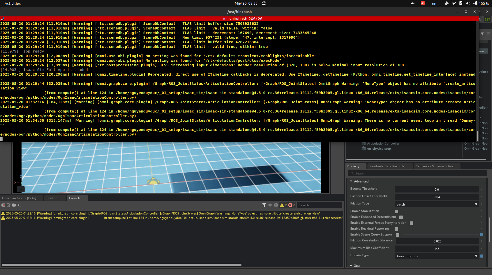

I want to physics simulation and render simulation run separately. Because if they run sequentially, topic joint_state will not publish message while rendering. If they run separately, ROS2 Isaac Sim communicates continuously without be blocked while rendering.
I tried only asynchronous update type in physics scene. Simulation run normally
I tried only ROS2 action graph + synchronous update type (default). Simulation run normally, I can subscribe message from topics
But when I combine asynchronous update type with ROS2 action graph. Simulation is stopped then crashing.

Hi @v.ducnd32! Could you share error messages or crash log from Isaac Sim?

I send the record video when run synchronous and asynchronous:
  1. Synchronous: There were warnings but it still worked
  2. Asynchronous: Because isaac sim paused or freezed, I could not interact or saw any logs

Hi @v.ducnd32. Thanks for your file and videos. When I open the usd file (without setting asynchronous update type), Isaac Sim would immediately freeze for me without any error or dump info from the log. Let me reach out to the internal team for this issue.

Hi @v.ducnd32 could you please clarify how you run it in sync and async modes? Is there a particular command you use or did you change it somewhere in the Isaac Sim GUI? Thanks!
Hi @v.ducnd32! More updates from the internal team. The async updates are not supported in Isaac Sim 5.0
