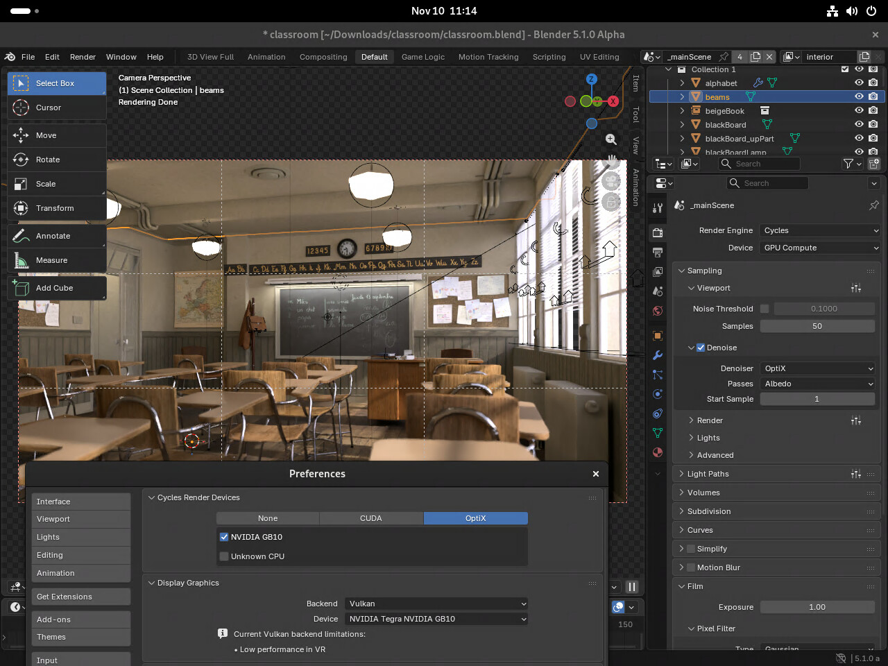

I got Blender 5.0 running on a GB10 system with CUDA, OptiX, and Vulkan working!
If you’d like to try, I’ve created a GitHub repo with what I did. I’ve written a build script (builder.sh) that compiles Blender and the required dependencies.
However, this is sill experimental. It installs files system-wide and does have some conflicts with certain apt packages, so (1) there is a chance it breaks DGX OS and (2) I’ve validated this on a clean install of DGX OS 7.2.3, but an install with many added packages may cause issues.
The build script is set to build Blender 5.0, but this seems to work for 5.1.0 (alpha) too. Several demos have been tested, including the Classroom demo, the “Charge” Open Movie demo, and the House of Chores demo.

@ambrosemcduffy Sure, here’s some render times. The 3070 was with the 5.0.1 RC from BuildBot and the GB10 was with my build of 5.0.1 RC. Both had it in Vulkan mode with Cycles Render Devices set to OptiX with either the 3070 or GB10 as the device (CPU unchecked). I loaded the .blend file into tmpfs and disabled swap.
This is just one-off renders (not the average of multiple) of the Italian Flat demo scene (frame #3), so I wouldn’t treat them as well-tested benchmarks/numbers, but rather a quick test.
Test RTX 3070 GB10
Base scene 01:45.27 01:31.11
OptiX denoise (Albedo & Normal) 01:33.70 01:29.20
OptiX denoise (Albedo & Normal) , 2048 samples [no noise threshold] 3:39.60 04:22.31
It’s worth noting that this scene fit into the memory of both systems. I don’t recall the exact number, but the render time for one frame of the Classroom demo was ~32 seconds. I’d guess that if you were to try a larger scene (i.e., that didn’t fit into the 3070’s VRAM), the GB10 numbers would look substantially better in comparison.
For the shaders, they seem to work correctly out-of-the-box. In the video demo, I set the environment shader to an HDRI from Poly Haven, but that was just because I wanted to, it wasn’t required for it to work. The numbers in the table are with shaders as-is.
