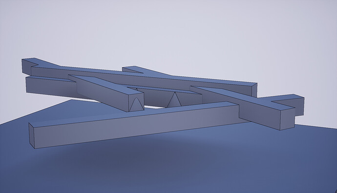

I recently purchased an Nvidia 3060ti and have found it is unable to properly render a sobel filter post process material in Unreal. The effect works correctly on AMD hardware I have used. I’m assuming this is an Nvidia specific problem, but I don’t have any other Nvidia gpus (atleast not any made in the last decade) to test on so I can’t say for certain. Due to this before I file a bug report with Epic I would appreciate if anyone else can confirm that this happens on other Nvidia cards.
I have included an Unreal sample project demonstrating the error.
https://www.dropbox.com/s/4dy2q3510n10ov7/SobelFilterTest.zip?dl=1
The project is 4.27, but the error occurs on 5 and 5.1 (and likely pre 4.27 versions as well, but I haven’t tested this)
This is the correct result from the RX580 and Vega 11. (I’ve disabled anti aliasing for these pictures)

I have tracked down the cause to the (scentexture invsize * outline size) part of the shader.
If the outline size is increased to 1 or higher the error does not occur.
The error also does not occur if the screen percentage is increased to 150%.
This effect is critical for the game I am developing, and neither of these workarounds are viable, 1+ outline size is far too thick for my game’s style, and increasing the render resolution to 150% is obviously not a viable solution.
(that’s all. ps: please remove these obnoxious posting restrictions from my account.)

I tried your Demo project and can confirm that it looks rather “jagged” in places. I tinkered a bit with the kernel parameters of the Sobel Operator, using for example Sharr or Prewitt. But the result did not improve much and will likely not be enough for your needs.
I don’t think this issue is a hardware bug as such, I rather think it is an issue somewhere in the translation of the material graph to actual shader code for NVIDIA HW. This might be in UE or in our driver, I cannot say for certain.
I will talk to some engineers internally and check if there might be some known issue or possible workaround. But I can’t promise that there will be a quick solution available for you.
Did you look into other approaches to do cartoon shading, if that is what you want to achieve?

Right, that last screenshot looks really bad.
I have the feeling that applying a hand written shader using the Sobel kernel directly on the color buffer during the fragment shader pass and using proper depth buffer information would yield better results.
Looking at the “decompiled” Material Graph there are a lot of UE specific comments regarding depth information accuracy that could easily cause this.
Well, speculation does not help you, and if your project does not already contain low level C++ code to add your own shaders, then it might be somewhat of a steep ramp to do so.
I cannot promise how fast I get some more eyes on this, but I find the visuals already pretty cool, so I might put some personal interest behind this :-)

Yeah it stands out more in my project because I also run it on the diffuse GBuffer (I almost exclusively use solid colours on everything), in addition to the normal and depth GBuffers used in the example project.
I tossed in a cube with a dithertemporalAA opacity mask to trigger the filter on basically every pixel and visualize the error better and this is what happens.
Top is Nvidia bottom is AMD.
And these overlaid in my project. I blew out the levels of the error overlay to visualize it better. (I don’t know why there’s vertical lines in 5.1 v 4.27)
I don’t really know what to make of it, the horizontal lines line up perfectly with every broken area, but the vertical ones do not. The only thing that potentially comes to mind is that some sort of precision error making it feed garbage UVs into the sampler which makes it detect an outline since it’s sampling either the wrong pixel or one that doesn’t exist. That could explain why it works correctly with an outline size of 1, after all 1/xy resolution and then multiplied by 0.5 would result in some very small numbers, but there’s a good chance I’m wrong since graphics programming is pretty far out of my skillset.
