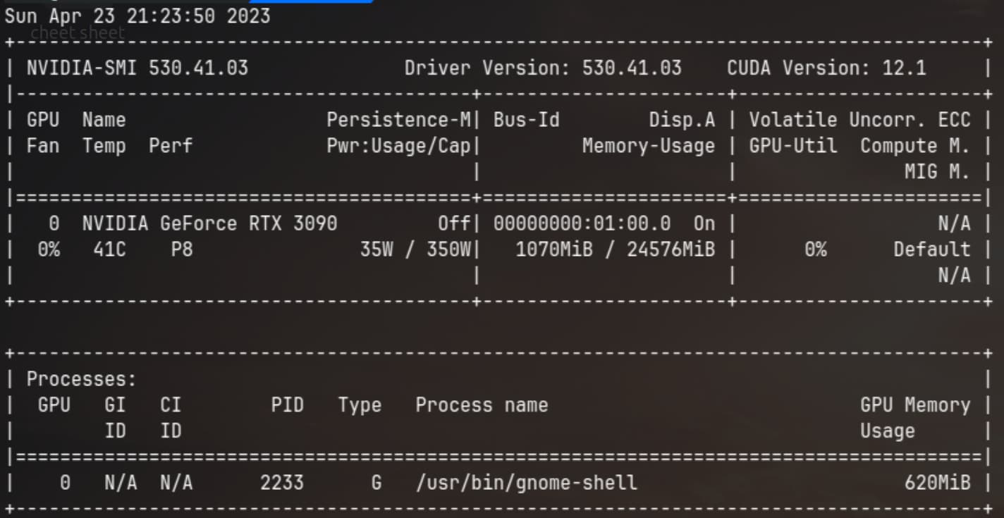

Probably no need to reply as amrits already reproduced the issue, but I can also see high power consumption with 2 1440p 165Hz displays.
Screenshot_20230329_220348
EDIT: This seems to not occure when using 525.89.02 but it is present in 530.41.03
Screenshot_20230330_231433

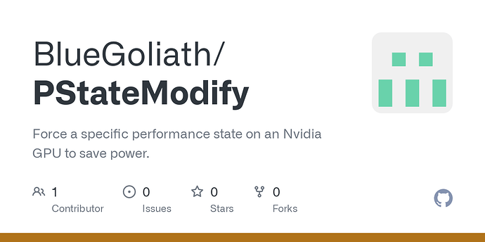

Use this to reduce power usage at the desktop.
I can’t believe that I was drawing 117W from the wall last 2 years 12-16 hours a day for nothing. Unbelievable!
