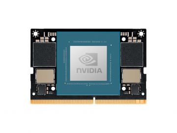

The attached is the output I get :
flashing sequence.txt (274.6 KB)
Now I am not sure what I have missed?
Can some one please help.

I have not created any custom device tree. How can I do it?
Using SDK Manager I can flash the device with JP 6.0:.
In the dts file I have changed the following to work with SDK Manager for my custom carrier board:
/home/developer/nvidia/nvidia_sdk/JetPack_6.0_Linux_JETSON_ORIN_NANO_TARGETS/Linux_for_Tegra/bootloader/generic/BCT/tegra234-mb2-bct-misc-p3767-0000.dts
  • cvb_eeprom_read_size = <0x100>
  • cvb_eeprom_read_size = <0x0>
Even in a flashed Jetson Orin if I replace my built kernel in /boot folder in nvme and reboot the device boots.
Questions:
With this kernel, where is the standard DTS for Orin Nano and NX(name and path of file)? I need to make sure the DTS has the EEPROM changes.

So to understand things, you are able to flash your device with the SDKManager but not with the flash command? Analyzing better your flashing command, I notice that it differs a bit from the recommended one by NVIDIA in their documentation. You may want to test with:
sudo ./tools/kernel_flash/l4t_initrd_flash.sh --external-device nvme0n1p1 -p "-c ./bootloader/generic/cfg/flash_t234_qspi.xml" -c ./tools/kernel_flash/flash_l4t_t234_nvme.xml --showlogs --network usb0 jetson-orin-nano-devkit nvme0n1p1
Regarding the device tree files, the standard dts for an Orin NX is located at hardware/nvidia/t23x/nv-public/nv-platform/tegra234-p3768-0000+p3767-0001-nv.dts
In order to create a custom device tree. You could create a new file over the hardware/nvidia/t23x/nv-public/nv-platform/ directory and add it to its Makefile in order to get it compile. Then you can make your customizations based on the standard DTS file. You could also backup a copy of the standard DTS file and work over that file. After doing so, you have to compile the device tree and test it by sending it over ssh or replacing the Linux_for_Tegra/kernel/dtb dtb file that you just compiled.

I followed these below instructions from Waveshare and I see that still its the same, It fails with following msg :
Waiting for target to boot-up…
Timeout
Device failed to boot to the initrd flash kernel. Please retrive the serial log during flashing to debug further.
Cleaning up…
Hardware I have :
Orin 8 GB Production Nano or NX( Its a non EMMC and I need to boot from NVME)
Custom carrier board with out EEPROM.

Any help would be appreciated, How to fix this issue?
Hi @shanbhagm
Have you been able to flash the device with the flashing commands (not the SDKManager) before performing the modifications? I strongly suggest you follow the recommendations from this forum Jetson Orin Nano (Super) boot from NVMe - using a VM to configure this. Many users experience problems with virtual machines. If possible, move to an Ubuntu machine or try to follow the instructions of the forum.
Please also provide the full log of the flashing process and get the serial log while flashing the device. You can follow the following instructions to connect a serail cable: NVIDIA Jetson Orin Nano - Serial Console.
