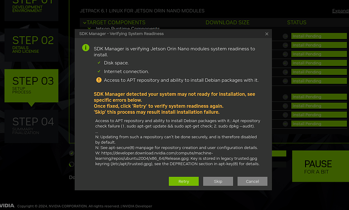

Hi @EduardoSalazar96 and @proventusnova ,
When i try, there was a error, Can you help me?
Hello @onurrcifcii,
That is strange, the board seems to be having issues with verifying APT Repos Availability.
What happens if you run the command SDK Manager is trying to run on your board?
sudo apt update && sudo apt check: sudo dpkg --audit
It might also be that during your tries of installing DeepStream yourself, something might have broke.
Let’s try running the commands and checking what is going on. If we are not able to go past the issue, there is always the chance to reinstall the complete system from scratch.
regards,
Andrew
https://proventusnova.com/embedded-software-engineering-support/
@proventusnova
Output is that;
onur@ubuntu:~$ sudo apt update && sudo apt check: sudo dpkg --audit

Thanks,
Lets try then hitting skip on the Very System Readiness step on SDK Manager when it throws the error you are currently seeing.
Keep me posted.
regards,
Andrew

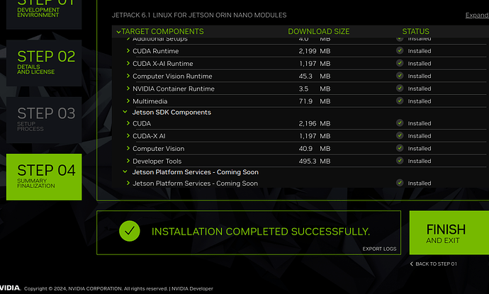

@proventusnova
It finished in 1 second.
@onurrcifcii,
Looks good.
Can you try verifying DeepStream is installed?
regards,
Andrew
@proventusnova I guess no, I think it said finish in 1 second without any loading.
onur@ubuntu:~$ dpkg -l | grep deepstream
iU  deepstream-7.0                               7.0.0-1                                           arm64        Nvidia DeepStreamSDK runtime libraries, development files and samples

And here is the log file;
SDKM_logs_JetPack_6.1_Linux_for_Jetson_Orin_Nano_modules_2024-10-15_19-00-45.zip (310.6 KB)
Perhaps a summary of what I have done before will help you:
I tried before to install DeepStream on my NVIDIA Jetson Orin Nano but encountered issues with missing dependencies and possibly outdated repository keys.Here’s a summary of what I tried regarding updating the CUDA Linux GPG Repository Key:
  1. I attempted to download the GPG key from NVIDIA’s repository using the following command:
wget https://developer.download.nvidia.com/compute/cuda/repos/jetson/ubuntu2004/x86_64/3bf863cc.pub -O /usr/share/keyrings/nvidia-cuda-keyring.gpg
However, I received a 404 Not Found error, which indicates that the key might have been moved or no longer exists at that URL.
2. I also tried adding the key using apt-key , but it gave me a warning that apt-key is deprecated and the key could not be fetched.
sudo apt-key adv --fetch-keys https://developer.download.nvidia.com/compute/cuda/repos/jetson/ubuntu2004/x86_64/3bf863cc.pub
Result: No data error.
3. I edited the /etc/apt/sources.list.d/nvidia-cuda.list to include the repository, but still faced issues with missing GPG keys when attempting to install CUDA-related packages.
I appreciate any help you can provide. @proventusnova @EduardoSalazar96
Now, A warning appeared above and said to write this, I wrote it and now I think it has been completely deleted :/
I tried the SDK manager again but it still didn’t work.
