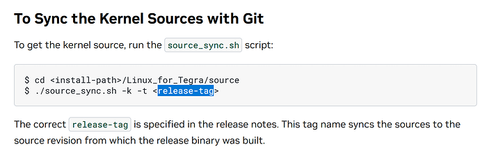

这个命令应该写什么呢?
Take r36.4.3 for example,
./source_sync.sh  -t jetson_36.4.3

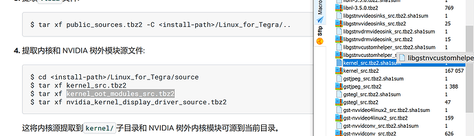

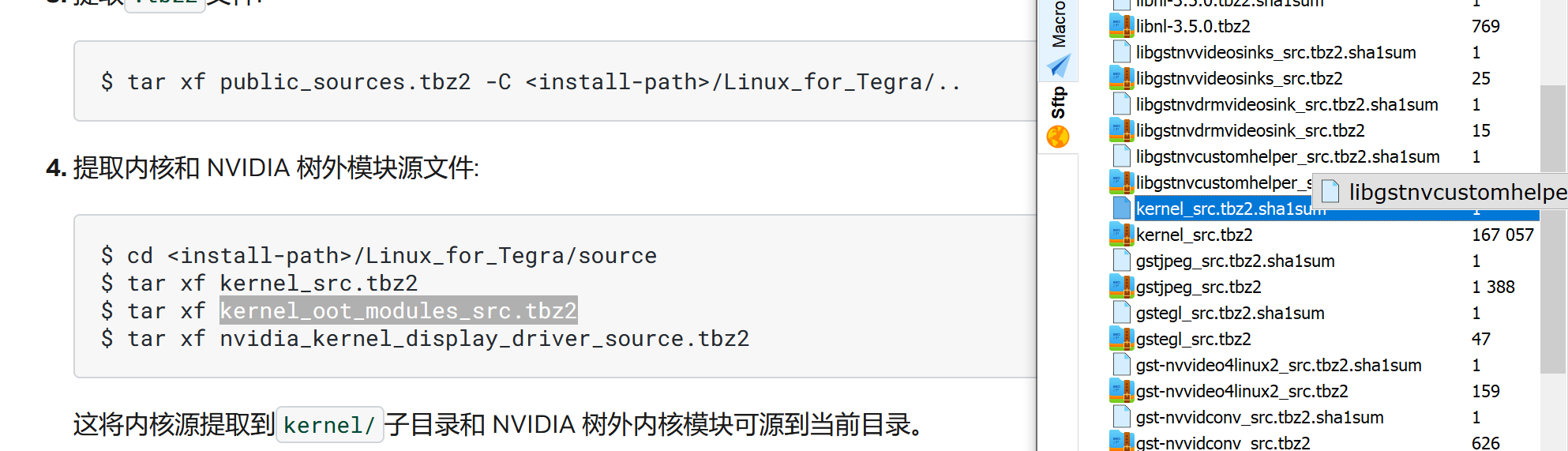

this“kernel_oot_modules_src.tbz2”怎么找不到呢,貌似解压出来之后没有?Can’t find it. After decompressing, it’s not there? What went wrong?
Teacher, I can’t find this“kernel_oot_modules_src.tbz2”.
You can run source_sync.sh to get the source code. Or download this package:
Jetson Linux Release 36.4.4 | NVIDIA Developer
Driver Package (BSP) Sources
Here is an example of kernel customization:
No data from Joystick Logitech-f710 - #10 by DaneLLL
Because you need to revise device tree, you would need to do the steps Building the DTBs(not do in the example since we use developer kit and can use the default files)
