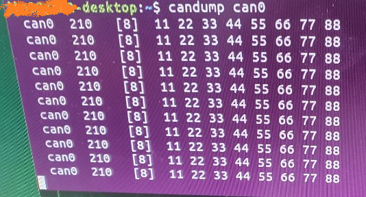

(3) I connected CAN Bus Module CAN H&L wire with Target ECU then I could received intended data frames
but I couldn’t send my data frame to Target ECU

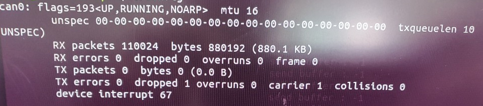

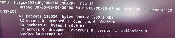

To explain in more detail, I could see the CAN0 Status <UP, RUNNING, NOARP>
but after use ‘cangen’ or ‘cansend’ CAN0 status changed to <UP,NOARP>
then receive function is not work likewise send function.
