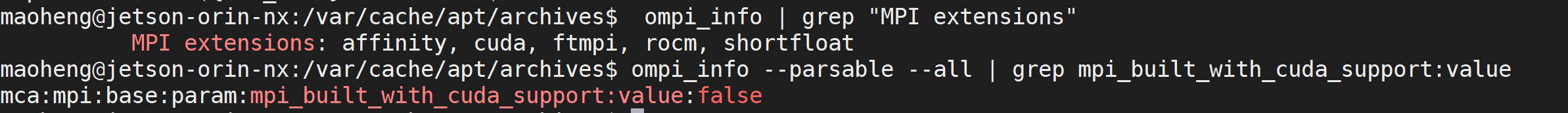

I want to use a jetson orin nx and jetson orin nano to build a distributed environment ,and I want to use mpi to communicate , so I install openmpi as ucx and openmpi official website :
configure as follow:
# configure environment
export CUDA_HOME="/usr/local/cuda-12.2" && \
export UCX_HOME="/usr/local/ucx" && \
export OMPI_HOME="/usr/local/ompi" && \
export PATH="${CUDA_HOME}/bin:$PATH}" && \
export PATH="{UCX_HOME}/bin:$PATH}" && \
export PATH="{OMPI_HOME}/bin:$PATH}" && \
export LD_LIBRARY_PATH="${CUDA_HOME}/lib64:$LD_LIBRARY_PATH}" && \
export LD_LIBRARY_PATH="${UCX_HOME}/lib64:$LD_LIBRARY_PATH}" && \
export LD_LIBRARY_PATH="${OMPI_HOME}/lib64:$LD_LIBRARY_PATH}"

Then, I use two command to verify:
ompi_info | grep "MPI extensions"
ompi_info --parsable --all | grep mpi_built_with_cuda_support:value
I don’t know why , I build with cuda all the time .

I want to use CUDA AWARE MPI, but the solution probably not。
According to my search results, to realize CUDA AWARE MPI, I must build from the source code, but after I build from the source code,use vertify command:
It shows mpi_built_with_cuda_support:value:false ; I don’t know why.
