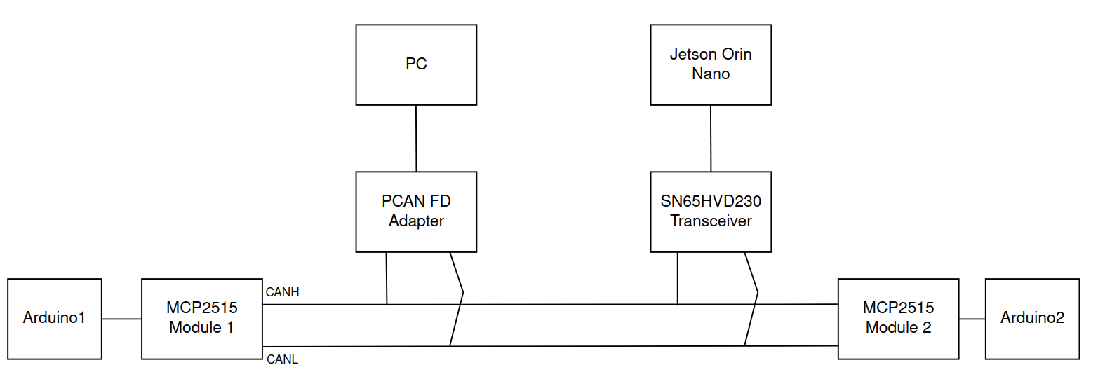

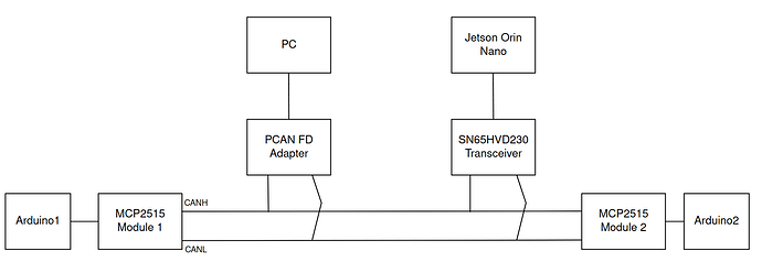

The connection for everything is in the below image.
I use CAN Explorer on MATLAB to retrieve CAN Messages from the bus. Both the CAN Explorer and Arduino is set to bit rate 500 kbps, similar to what i initiated for Jetson.
To test, I used 2 Arduino to generate messages with different IDs. All the messages generated by the Arduino boards can be detected on CAN Explorer. However the message with ID 123 that I generated on the Jetson is not detected.
I did make sure to connect everything and retrieve messages from Arduino before connecting the Jetson to the bus and initiate the CAN controller.
Is there anything that I did wrong here? Hopefully someone can help me with this. And please let me know if I should provide any further info about my system.
Thank you so much

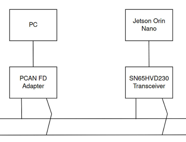

Could you simplify your setup with just connecting CAN from Orin Nano with PCAN from host PC as following? (i.e. remove two MCP2515)

I used 2 MCP2515 here to try and send messages from 2 Arduino board, and to use the terminating resistors on them, as I didn’t have any spare resistors. I will try simplifying my setup like you told and come back to you later.

Hello Kevin,
after following your advice to simplify my setup, I could finally receive and read CAN message on my PC using the PCAN FD Adapter. One possible fault in my original setup could be that all 3 modules (2 MCP2515 and 1 SN65HVD230) had a 120 Ohm resistor, this might have caused the Jetson to go into error states. After this I simplified my setup and double checked that only 2 terminating resistors were in my CAN Bus setup.
