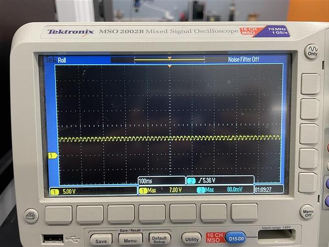

I am currently working on project where it requires CAN from the Jetson Nano Orin. While I was successful getting it up and running, and I can only read data coming from the Tiva TM4C123GH6PM, which is sending data. The CAN_TX does not appear to be working as when I do “cansend can0 100#DEADBEEF”, I do not see that data on my on another micro-controller acting as a reader.
The picture is the Jetson reading the data, this is the correct ID and data from the Tiva TM4C123GH6PM.
I went ahead and checked the the pin for the CAN_TX by using an oscilloscope, and I do not see the data being transmitted what so ever, as shown in the picture above.
For context on the Hardware I am using the following:
  • CAN Transceiver: MCP2551 running on 5V
  • Microcontroller: Tiva EKG-TMC123 Development Board
The only modification I made was soldering pins so that I can attach jumper cables to it, but otherwise I am clueless as to why it is not working…

Hi c.a.mendoza4508,
Are you using AGX Orin or Orin Nano?
(your topic is in AGX Orin category but you mention Orin Nano here)
Please check CAN-H/CAN-L instead.
Could you share the block diagram of your connections for further check?
You can also provide the steps how do you configure and setup CAN interface.
