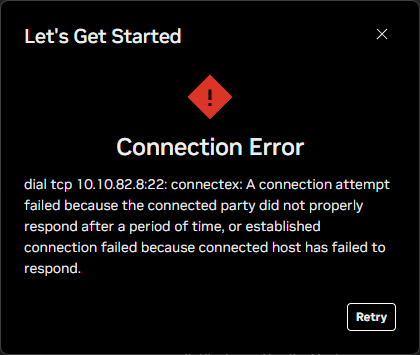

Installed NVDIA sync on my Mac and set up DGX yesterday. Everything worked fine. This morning I tried to connect and get daemon not running error in NVDIA sync app. Tried rebooting Mac and DGX multiple times…no luck in connecting.

after numerous reboots, I’ve been able to connect via a local monitor and keyboard…can also ssh to DGX Spark from my Mac. Nvidia Sync will not connect. I uninstalled, re-installed and tried to add back DGX in settings but get the above error. SSH works however.
I finally got it to boot up…I still cannot use NVDIA Sync…I shared a screenshot of the error. It wouldn’t connect so I re installed the Sync app on my Mac and tried to add back my DGX but get the error re knownhosts file, byte 140…
But ssh works into the DGX from the same Mac.
It looks like the public key you are trying to use is invalid or of an unsupported type. Please try to make a new key pair and see if that helps
this was generated by the Nvidia sync install. I can use SSH with this key. The Sync app stopped connecting…I re-installed and now get the above key error.
Hmm, you may need to delete the ssh_config file to reset the connection NV Sync has, as well as delete the corresponding NV Sync entry in the known_hosts file on your Spark.

When I try to log in via Terminal, the connection aborts right after entering the password — no login.
Interestingly, if I disconnect the LAN cable and use Wi-Fi only, it works fine.
Could this be related to having two IP addresses active at the same time?
@leucir, you continue to get this error after deleting the known_hosts file on your local machine?
I was able to fix it after reboot (not gracefully) the Spark box.
I haven’t had a similar issue again
