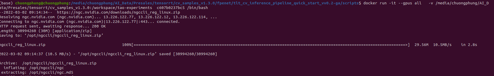

I run everything in docker: nvcr.io/nvidia/tao/tao-toolkit-tf:v3.21.11-tf1.15.4-py3

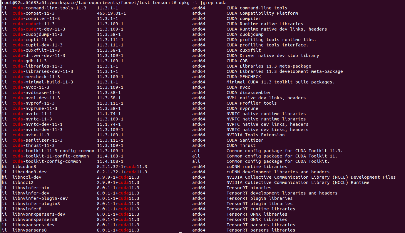

What is "$nvidia-smi " and "$dpkg -l |grep cuda "?
And how did you trigger this tao docker?

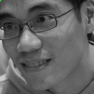

Is landmarks.jpg expected?
No. All landmarks are in range [0,3]
landmarks

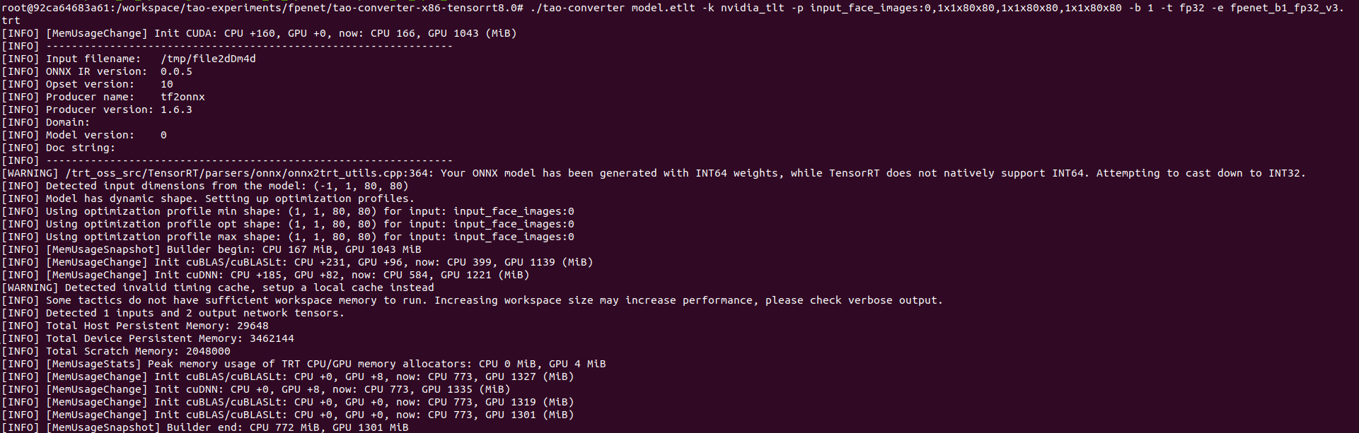

This is the command, I used to convert etlt model to .engine file:
./tao-converter model.etlt -k nvidia_tlt -p input_face_images:0,1x1x80x80,1x1x80x80,1x1x80x80 -b 1 -t fp32 -e fpenet_b1_fp32_v3.engine
Here is the output of the above command:
[INFO] [MemUsageChange] Init CUDA: CPU +160, GPU +0, now: CPU 166, GPU 1055 (MiB)
[INFO] ----------------------------------------------------------------
[INFO] Input filename: /tmp/fileovkvDS
[INFO] ONNX IR version: 0.0.5
[INFO] Opset version: 10
[INFO] Producer name: tf2onnx
[INFO] Producer version: 1.6.3
[INFO] Domain:
[INFO] Model version: 0
[INFO] Doc string:
[WARNING] /trt_oss_src/TensorRT/parsers/onnx/onnx2trt_utils.cpp:364: Your ONNX model has been generated with INT64 weights, while TensorRT does not natively support INT64. Attempting to cast down to INT32.
[INFO] Detected input dimensions from the model: (-1, 1, 80, 80)
[INFO] Model has dynamic shape. Setting up optimization profiles.
[INFO] Using optimization profile min shape: (1, 1, 80, 80) for input: input_face_images:0
[INFO] Using optimization profile opt shape: (1, 1, 80, 80) for input: input_face_images:0
[INFO] Using optimization profile max shape: (1, 1, 80, 80) for input: input_face_images:0
[INFO] [MemUsageSnapshot] Builder begin: CPU 167 MiB, GPU 1055 MiB
[INFO] [MemUsageChange] Init cuBLAS/cuBLASLt: CPU +231, GPU +96, now: CPU 399, GPU 1151 (MiB)
[INFO] [MemUsageChange] Init cuDNN: CPU +185, GPU +82, now: CPU 584, GPU 1233 (MiB)
[WARNING] Detected invalid timing cache, setup a local cache instead
[INFO] Some tactics do not have sufficient workspace memory to run. Increasing workspace size may increase performance, please check verbose output.
[INFO] Detected 1 inputs and 2 output network tensors.
[INFO] Total Host Persistent Memory: 34032
[INFO] Total Device Persistent Memory: 2232320
[INFO] Total Scratch Memory: 2048000
[INFO] [MemUsageStats] Peak memory usage of TRT CPU/GPU memory allocators: CPU 0 MiB, GPU 4 MiB
[INFO] [MemUsageChange] Init cuBLAS/cuBLASLt: CPU +1, GPU +8, now: CPU 773, GPU 1292 (MiB)
[INFO] [MemUsageChange] Init cuDNN: CPU +0, GPU +8, now: CPU 773, GPU 1300 (MiB)
[INFO] [MemUsageChange] Init cuBLAS/cuBLASLt: CPU +0, GPU +0, now: CPU 773, GPU 1284 (MiB)
[INFO] [MemUsageChange] Init cuBLAS/cuBLASLt: CPU +0, GPU +0, now: CPU 772, GPU 1266 (MiB)
[INFO] [MemUsageSnapshot] Builder end: CPU 772 MiB, GPU 1266 MiB
