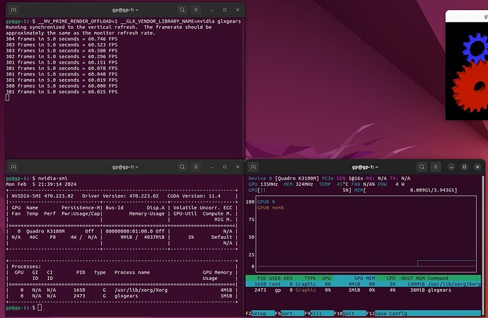

The nvidia gpu is in offload mode
https://http.download.nvidia.com/XFree86/Linux-x86_64/550.40.07/README/primerenderoffload.html
Try running
__NV_PRIME_RENDER_OFFLOAD=1 __GLX_VENDOR_LIBRARY_NAME=nvidia glxgears
Running synchronized to the vertical refresh.  The framerate should be
approximately the same as the monitor refresh rate.
302 frames in 5.0 seconds = 60.283 FPS
301 frames in 5.0 seconds = 60.007 FPS
301 frames in 5.0 seconds = 60.003 FPS
Watch nvidia-smi or nvtop while running, should show up.
This is the current status:
  • cogwheels are turning
  • first terminal window is showing ~60 FPS
  • nvidia-smi to me looks the same
  • nvtop shows some activity

You can see in nvidia-smi output clearly that glxgears is running on the nvidia gpu.
Yes, now I see it too. Thank you!
