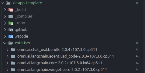

I’m trying to copy 4 extensions from the NVIDIA installation to my local extsUser folder for development:
  • omni.ai.chat_usd.bundle-2.0.4
  • omni.ai.langchain.agent.usd_code-2.0.3
  • omni.ai.langchain.core-2.0.2
  • omni.ai.langchain.widget.core-2.0.2
The original extensions are located at: file:///home/hung/.local/share/ov/data/exts/v2/omni.ai.chat_usd.bundle-2.0.4+107.3.0.cp311/

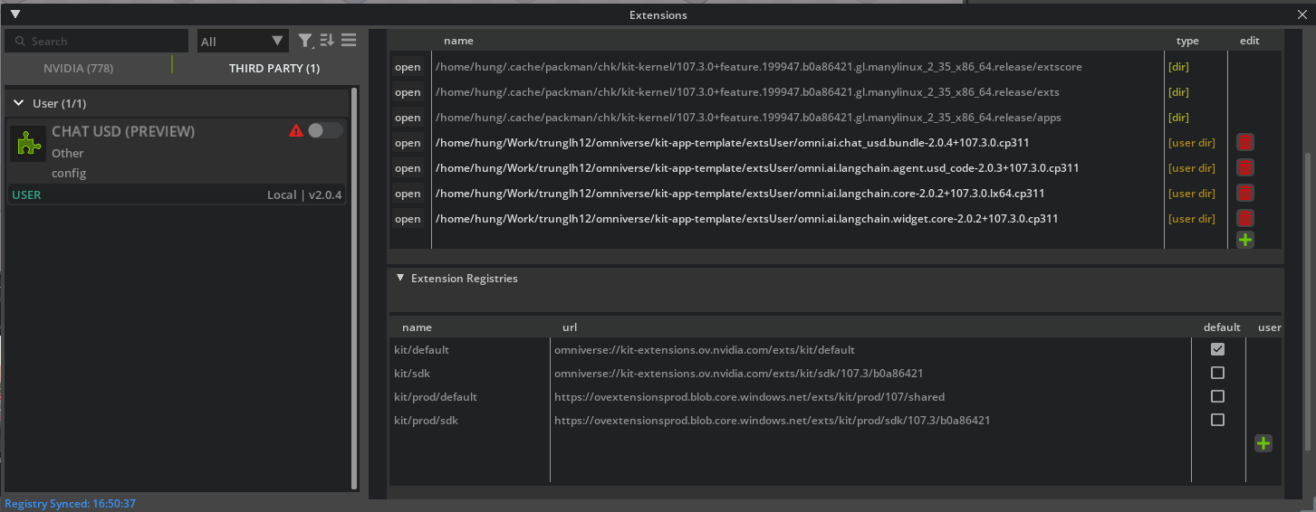

When I copy these extensions to my local development folder and add them to the Extension Search Path (e.g., /home/hung/Work/trunglh12/omniverse/kit-app-template/extsUser/omni.ai.chat_usd.bundle-2.0.4+107.3.0.cp311), I encounter module import errors when trying to enable the extensions.

  1. Copy the 4 AI extensions from /home/user/.local/share/ov/data/exts/v2/ to local extsUser folder
  2. Remove symbolic links and ensure actual directory content is copied
  3. Add the extension paths to Extension Search Path in Kit settings
  4. Try to enable omni.ai.chat_usd.bundle-2.0.4+107.3.0.cp311 extension
  5. Error occurs during extension startup
Error Messages
Current Error:
ModuleNotFoundError: No module named 'omni.ai.chat_usd'
Failed to import python module omni.ai.chat_usd.bundle. Error: No module named 'omni.ai.chat_usd'

(Extension Search Path configuration showing the local paths)
When I tried to insert the parent directory in the search path, /home/hung/Work/trunglh12/omniverse/kit-app-template/extsUser, no extension shows up.

  1. Resolved symbolic link issues: Initially the extensions were symbolic links pointing to the central installation. I removed the symbolic links and copied the actual directory content.
  2. Fixed missing init.py files: The major issue was missing init.py files in the Python module hierarchy. I created the missing files:
  • omni/init.py
  • omni/ai/init.py
  • omni/ai/langchain/init.py
  • omni/ai/langchain/agent/init.py
  • omni/ai/chat_usd/init.py
  1. Extension Search Path configuration: Added the local extension directories to the Extension Search Path in Kit settings.

Hi there and thanks for the post. I am afraid that no, we do not allow you to modify this code. It is provided to you for free and we are happy to give it, but it is not for modification as per our EULA. The other issue, is that it would be almost impossible for you to modify this very large code base which requires very specialized GPU clusters to hold this model in memory. No domestic card could hold this. And if you are using a 3060, then certainly not. You could not even hold 5%.
Please just use it the way it was intended. As a AI helper for USD Code inside of Omniverse USD Composer and Isaac Sim.
