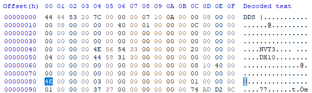

Changing this is a bit trickier, and requires a hex editor at the moment (I often use HxD or ImHex; the design is that ideally the engine should do this format changing, but it looks like the engine doesn’t do that here). After writing the DDS file using nvtt_export.exe, load the DDS file into your hex editor. You should see something like this:
Click on the byte at offset 0x80 and change it from 4D (hexadecimal for 77, which is DXGI_FORMAT_BC3_UNORM) to 4E (hexadecimal for 78, which is DXGI_FORMAT_BC3_UNORM_SRGB):
Then save the file back out. If UNORM_SRGB vs. UNORM was the root cause, the texture should now load correctly!
