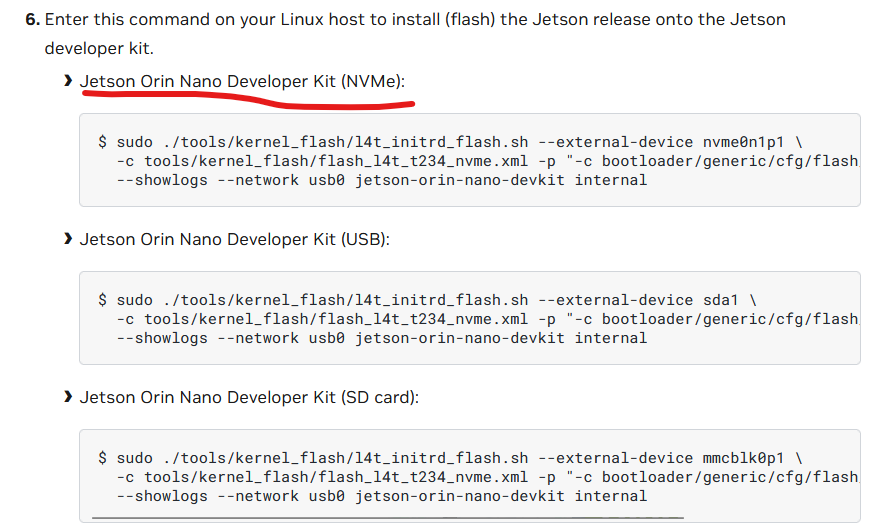

Thanks Kevin. I took new source altogether <Linux_for_Tegra>
Synced the source and built the kernel as is without any customization. Just followed the steps in the [customization] page.
after all those steps i flash with the following command:
sudo ./flash.sh jetson-orin-nano-devkit-nvme nvme0n1p1
The kernel boots but it cannot find init while booting. I get the error chroot cannot find the file /sbin/init. kernel panic.
I did flash the initrd and didn’t miss on any steps in that page.
Any way i can debug this or you know of anything i’m missing ? Is the flash command correct for nvme ? Any ideas what i can try ?
You should use this command for flashing Nvme:
Thank you, this worked!
ok. Mark my post as solution( tick) so that it will be useful to others.
